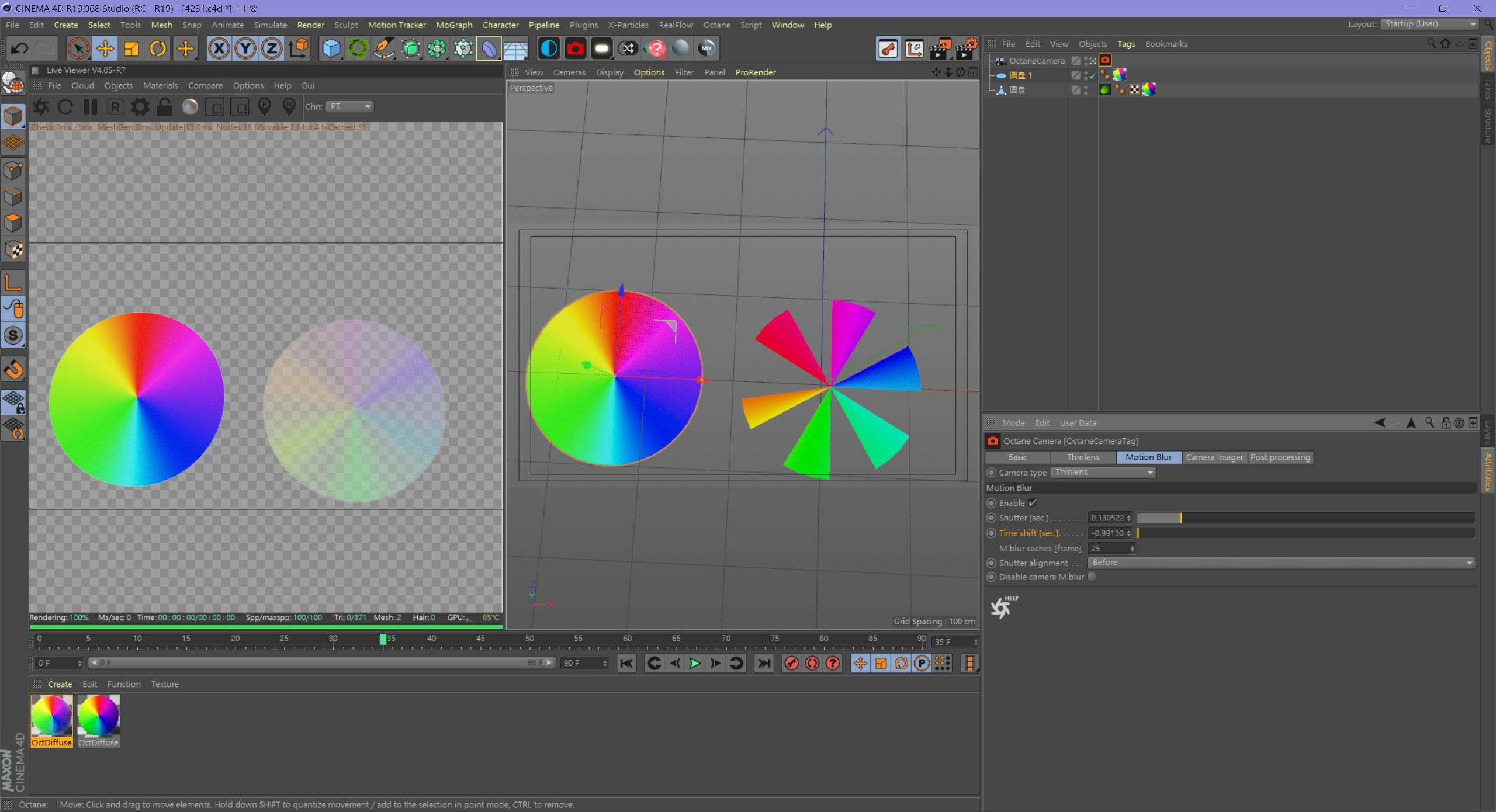

I want to try to make LED products for computer fans, but when testing the motion blur,
the chromaticity on the right is relatively low. Is there any other way to improve the chromaticity on the left?

That is an interesting problem. Try messing about with the Shutter [sec.] value in the OctaneCamera tag > Motion Blur tab. For 24fps, the shutter value is roughly 0.02 You can also adjust the shutter alignment and time shift values to see if you can get any closer. Also, make sure that your brightness on the emission node is high enough. You may wish to submit your scene to help at otoy dot com

HI
I have tried to make and find related teaching, but there are very few related teachings.
I tried to make a picture-like effect, but I failed. Maybe my production method is wrong.
Hope it can help me how to make a similar effect.
Thanks again.
Put the file I tried
