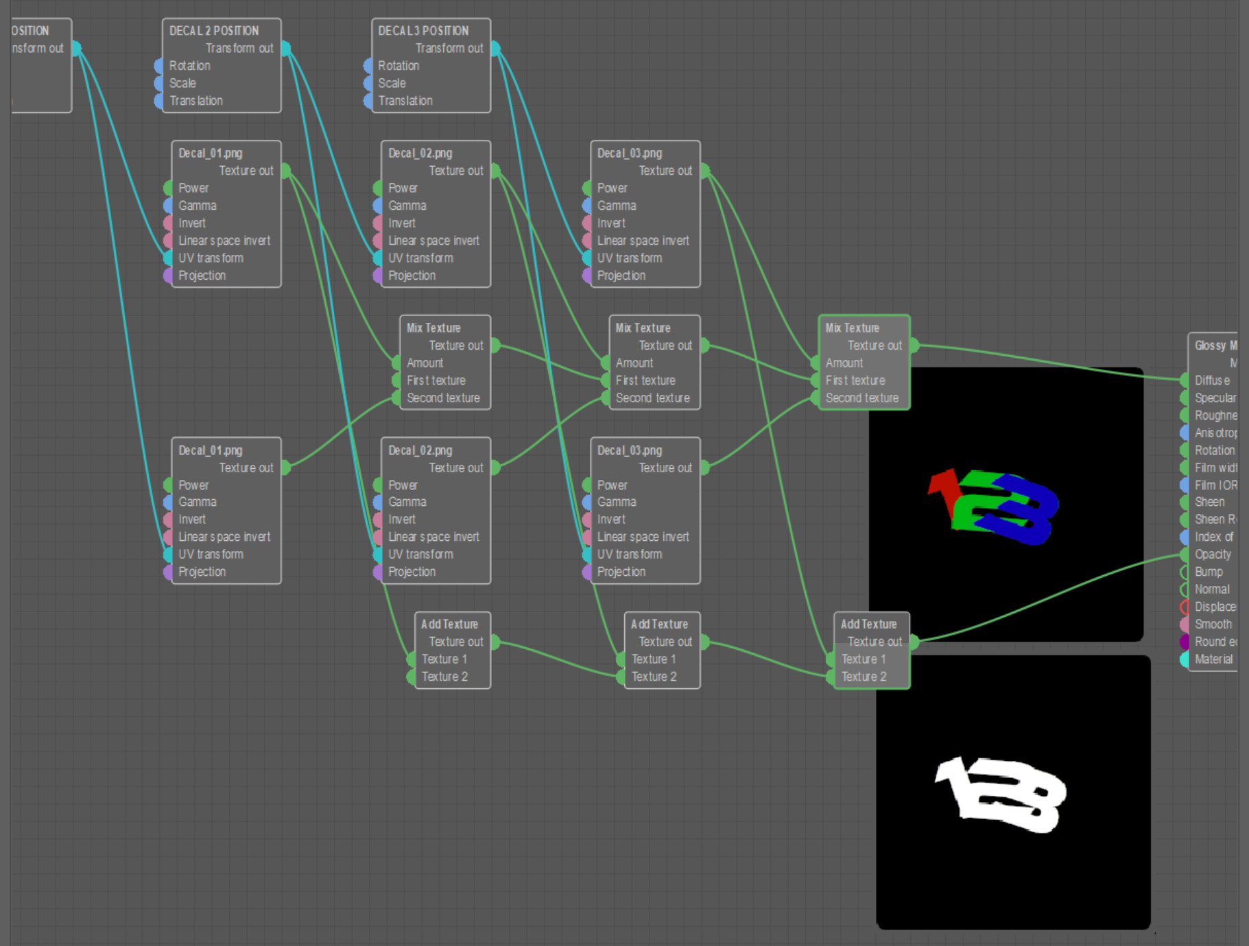

Here is an example where I put the three decals on a brick wall. The first decal is a red number 1, the second is a green number 2, and the third a blue number 3. Each decal is a colored PNG image of the number with a transparent background.
Below is the node setup of the Geo Shell. Basically each decal PNG is loaded twice - once as an RGBA Image used for the opacity and masking and secondly as a regular RGB Image for the diffuse color. It doesn't have to be 3 decals - you could follow this pattern indefinitely for any number of decal images you want to add.

There are a lot of ways to do this, but it will vary depending on the effect you're trying to achieve. A Geo Shell can be a great method, particularly if you don't want your decals to combine with the material they're on top of. You shouldn't need to use a separate Geo Shell for each decal though - you can combine them all in the material of a single Geo Shell.
