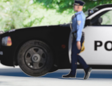

I'm having an issue where I get a white boarder around the shadow layer of my renders. You can see it in the snapshot around the car tires and around the boots. I have a police car and an officer rendered on one layer and the shadow catcher on the other layer render pass. I'm using Raw, AO and Shadow render passes.
I'm using Path Tracing and Thin Lens Camera and the latest version of Octane for Lightwave.
Any ideas on how to prevent this?
Thanks,
Jeff

I rendered these as 3D objects. The objects are from IClone. They objects are towards the back of the shot but the white boarder is noticeable in the footage.

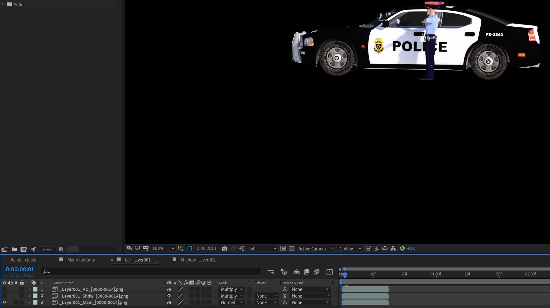

I have Car_Layer on top set to "Normal" in After Effects with the Shadow_Layer below that set to "Multiply".

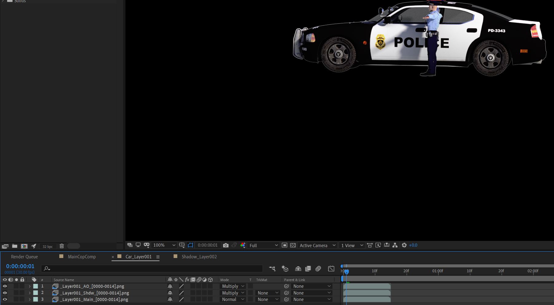

I just noticed that in my Car_Layer adding either AO or the Shadow layer with "Multiply" mode also adds the white line around the objects. When I turn them off and only show the Main layer, I don't get the white line.
White line shows on feet and car tire with AO and Shadow Layer
No white line shows with just the main render.

I played around with the settings. I render using MultiLayer EXR Tonemap, render all in one layer, then separate out the ground shadows with Cyptomatte, the white boarder disappears. Seems to be an issue when rendering out PNG 16 Tonemapped.
