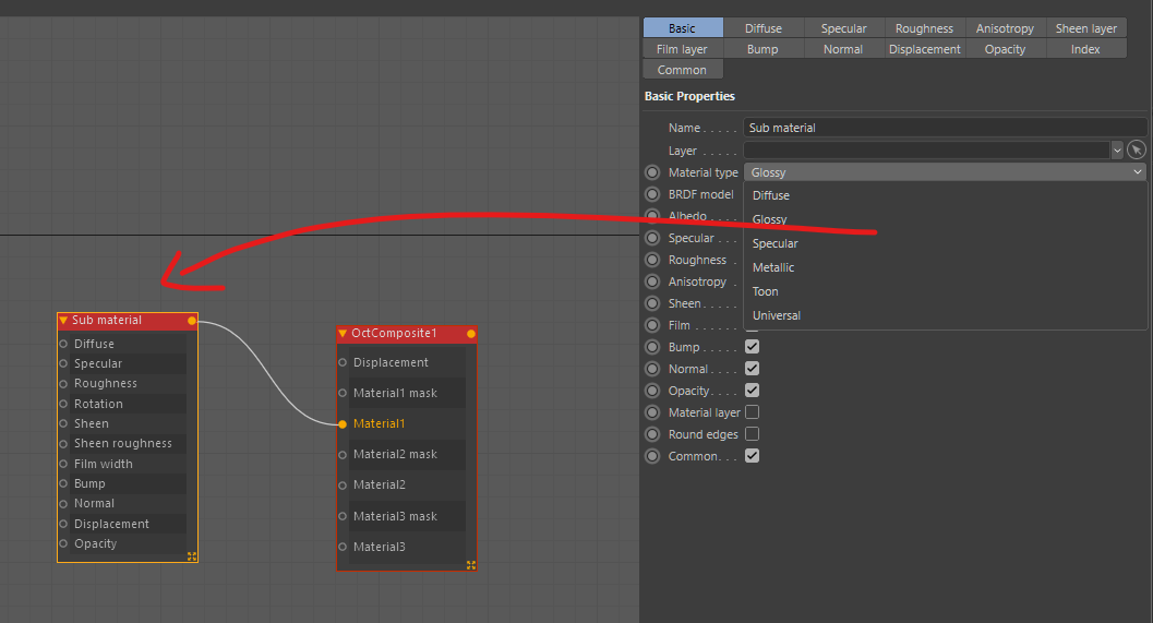

Any material from list can not be added to Layered material as a base material. It's only possible to add base material using button (add material).

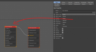

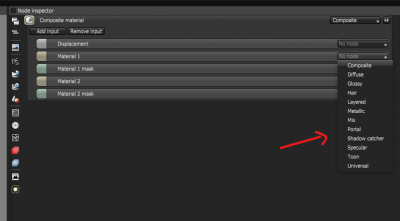

C4D plugin. Only submatrials. Not all available.
Standalone. All materials available.
What if I want to have one common material that is used across few other layered/composite materials? Any change to that common material would be seen instantly in other materials. In current workflow I would have to adjust every single materials to make a change.
Why not to give user an option to use either Sub material or Standard materials?
CPU – i9 13900KF, 128GB RAM, GPU – RTX 4090
System – Windows 11
My Behance portfolio, Blender plugin FB support group
Posts: 16068
Location: Türkiye
Explained why I chose this way. It's to avoid problems of mix material system. Keeping all stored in a compact way.
You can still convert octane materials to sub materials and connect. There's a command in node editor for doing this
