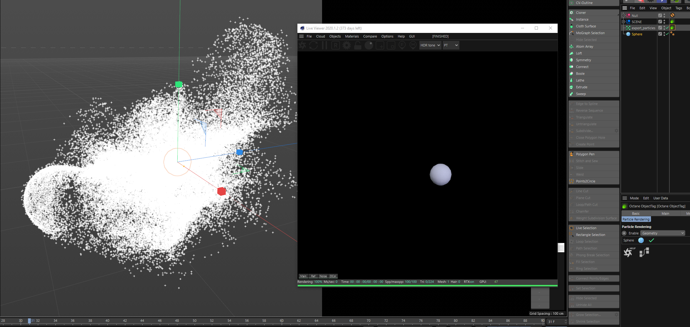

I have a 2.4gb alembic file with particles exported in Houdini, somehow the Octane tag keeps ignoring it when I enable particle rendering.
The alembic is working when I use octane scatter but it's not a solution for what I need to do, alembic has also been tested with redshift and works fine.
Anybody else has had this before?
I'm on 2020 in S22

Hi.
have you tried to import the alembic file into Standalone?
If the particles are not visible also there, an attribute is missing or differs in the .abc file, and octane cannot read the particles.
A workaround could be to try to use Thinking particles to transform the points in something that Octane can read.
ciao Beppe
Posts: 16066
Location: Türkiye
Probably it's not supported/recognized type for the plugin.
Could you share a sample scene with us to check it? I can debug and look for what can be done!

Thanks, will do!
I will send you a link to download the alembic on mograph slack..
