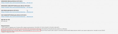

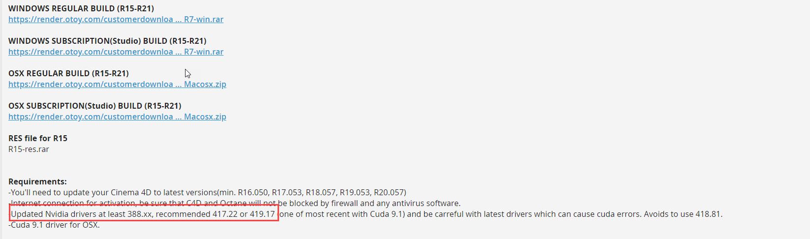

thanks,
but where do i get those nvidia versions. on the main downloads page there is just the actual version.
problem: i have to stay on 3.08, because thats the version my mac is on (all other versions dont work well on my mac...dont ask why...its a unlucky fact)
ugh.. and where do i find a 4.05 c4d download?

Posts: 16068
Location: Türkiye
under releases section of this forum. Upgrade it from shop page by free of charge
