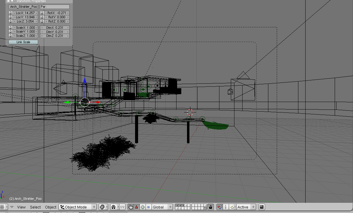

But I also want to lit the pool (the water of the pool is a box, in front of the box is a glass wall (a box as well).

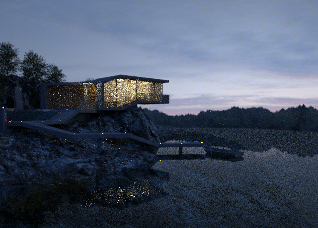

When I put 2 spheres objects into the pool (within the poolwaterbox) with a emitter material it doesn't lit the pool.

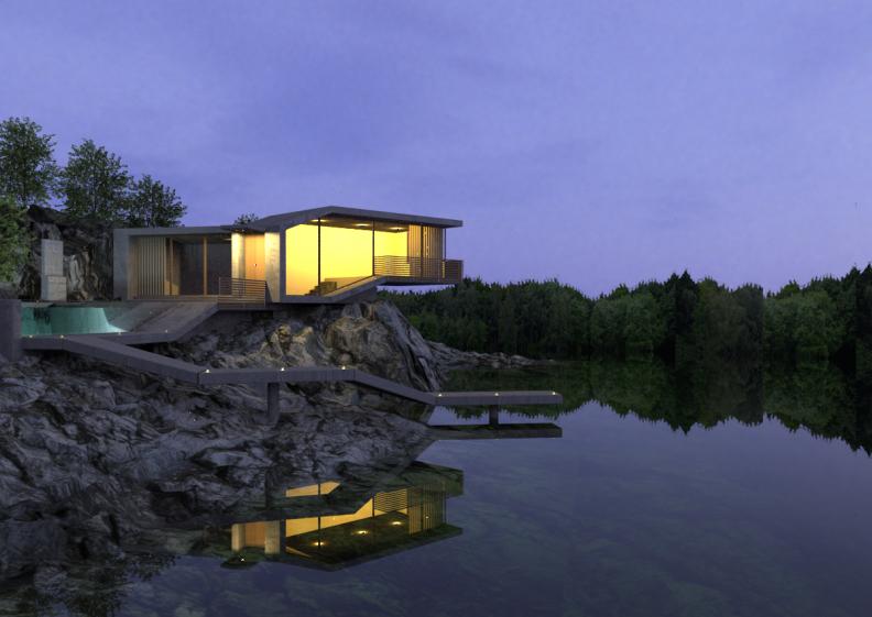

Compare the old yafaray rendering in the attachment.
In the screenshot you can see the position of the two spheres.
Does anybody have an idea what I do wrong ?

It seems that the light is not strong enough. I use now 4 spheres as a emitter objekt to light to pool, but its to dark there...

Currently, light doesn't pass through glass materials, so if your water is a volume instead of a surface, imho the faces of this volume prevent the light from reaching the walls of the pool.
