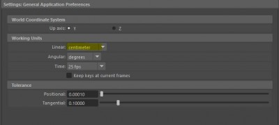

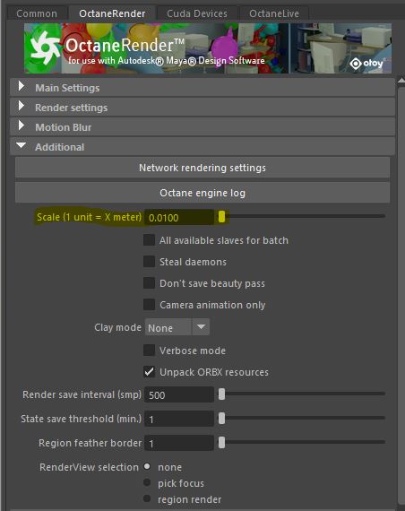

well from my additional test , i would say option 2.
keep scene in CM and set scene scale at 0.01. It's the only option that mimic octane standalone behavior with a cube of 1m with absorption.
but as i am no expert in octane, that would be nice if someone could confirm that.
EDIT :
After double testing, to get the exact equivalence between Octane for Maya and Octane Standalone you have to use this setup :
EDIT :

Hi Guys,
Yes I understand is confusing, the correct way is keep my default centimetres because all other stuff and workflow in Maya are based on that and then on scene scale set "0.01" for correct size.
So Why the default is 1 unit = 1 meter, is just because the numbers on shaders and nodes and transforms is based in meters inside Octane.
Because maya units is has limitation you have to set the number divide by 0.01 to get accurate response of shaders and etc. But check the orbx export you will see there is just a placement node add on the end of the scene scaling everything down. is what that scene scale does basically.
Hope this help to understand a bit. I would work like that Maya default centimetre and Scene scale at "0.01" we are doing that for a while on production.
Best,
JO
Best,
JO
