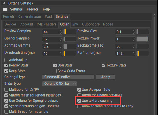

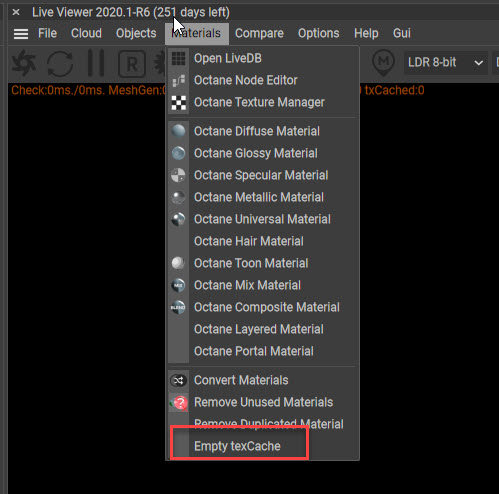

And what happens if you clear texture cache by "Empty texCache" and disable it from settings->other?
