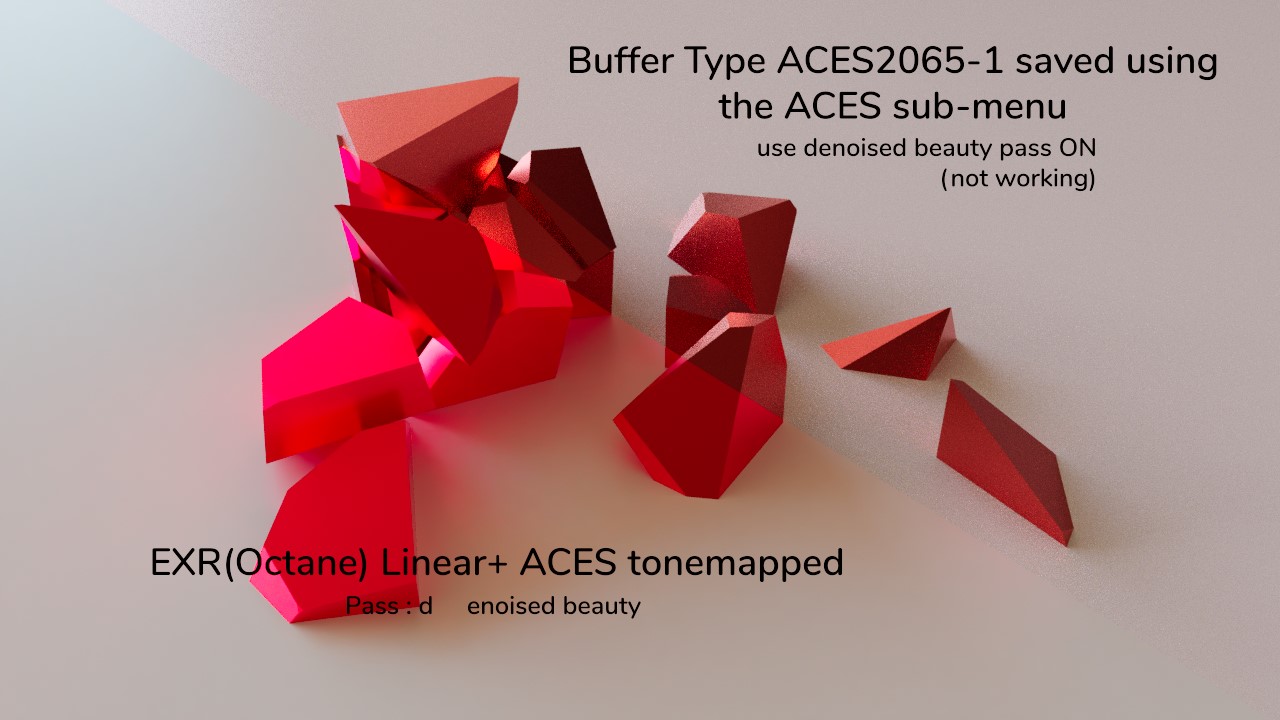

I am not able to render Passes and denoised beauty if I use the ACES filename box. it only save the noisy beauty . ( but is correctly saved as a s ACES2065-1).
in the passes section, I guess you have to choose ACES tone mapped? but the file saved (using the regular save filename) has passes but is still interpreted as a regular SRGB linear file...
I dont get why I cant get the passes correctly. tonemapping ACES onto a Srgb space is a bit pointless, or i missed a part of the workflow.

for me using a tone mapper means that you remap a space to another. so here it would be ACES to sRGB linear. while saving natively would save the file as withing ACES color space.
Maybe it is just an issue with file interpretation, however, within AE you can see that the file saved from the main sub-menu ACES path is recognized as ACES chromaticity(Linear) while the EXR(octane) passes file is read as a sRGB (linear) file.
FInally Using OCIO workflow. there is a difference between the octane EXR beauty pass and the beauty saved from the AXES sub-Menu. ( also the option of saving the denoised beauty doesnt work)
does this makes sense? did I do something wrong?
yes it feel like the Passes are still sRGB linearJengo_1 wrote:The only time it's not super saturated and reddish is when I select Linear RGB as input on the OCIO (even tho it's rendered as ACES2065). But it's still super noisy.
In short, you mean saved passes are not like with ACES but linear? I can test it if so.

aoktar wrote:In short, you mean saved passes are not like with ACES but linear? I can test it if so.
try to compare ACES and a beauty pass and you will see difference.
( and the denoiser is not working with ACES too).
Yes, it looks different and denoiser works. and AE interprets it as sRGB (linear). the same as the passes.jayroth2020 wrote: @charlieL, Did you try to set your render buffer type to Float (Linear)?
