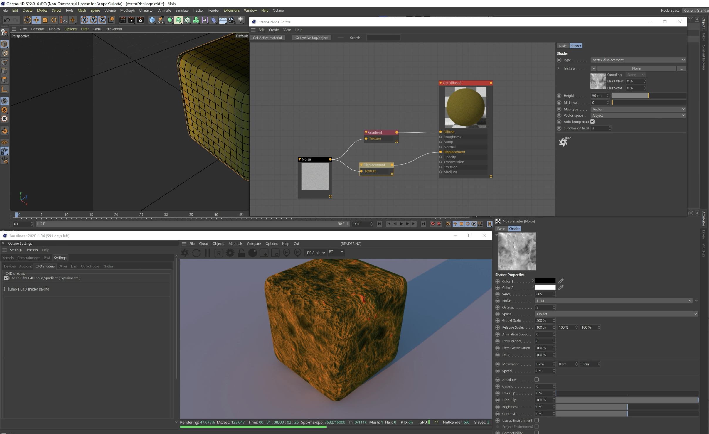

I've been trying to get a proper seamless displacement on a mesh using triplanar projection in conjunction with the vertex displacement node, but somehow I'm still stuck with broken edges (Center object is a cube with rounded corners)..
Any idea what I'm missing here ?
Thanks !

ok, some notes about Vector Displacement node.
If you use a map, you need to change the Map type to Height, instead of Vector, and more important, always use an ImageTexture node to load your map, in this way tou can Invert it, correct the Power, Gamma, Border Mode, and so on:
But you cannot expect to have correct mapping without correct uvs.
On the other side, if you use a procedural noise (you can use both Octane, osl or c4d Noise nodes), and the Vector Displacement Map type is set to Vector, it will be applied in 3D space, and you can change it from Object to Tangent:
To use c4d Noise in procedural way, you need to use 2020.1 and enable the OSL auto translation in c4doctane Settings/C4D Shader panel:
ciao Beppe
