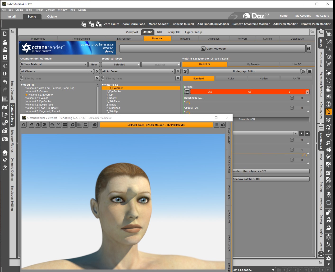

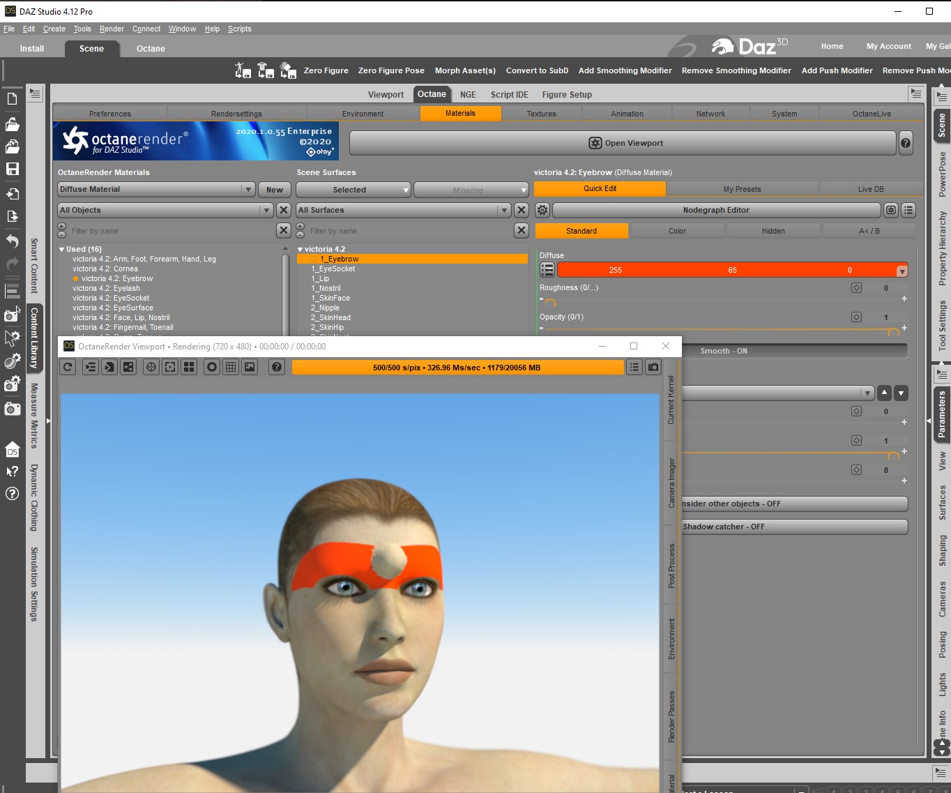

And here is 2 images. I added a morph that will intersect the eyebrow. But once you turn off the opacity, no artifact.
Eyebrow Visible and Opacity 1
Don't see artifact. Morph only applied to V4 and dialed to 0 on the eyebrow mesh so that they intersect. The first image shows that. This is with normal scale at 100% and no position change of the eyebrow.
Eyebrow Visible and Opacity 0

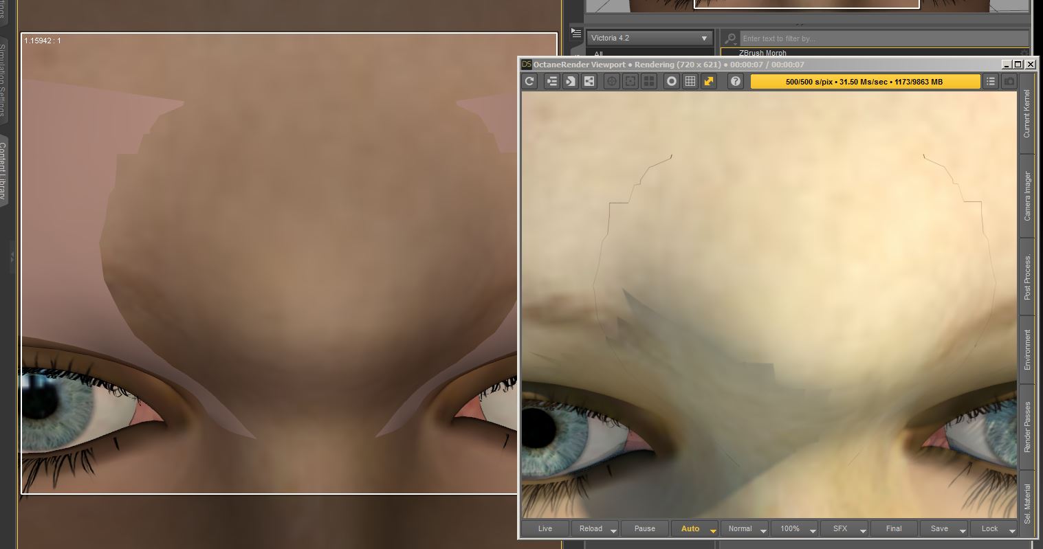

rajib wrote:And here is 2 images. I added a morph that will intersect the eyebrow. But once you turn off the opacity, no artifact.
The attachment MeshIntersectWithOpacity1.jpg is no longer available
It's there :) You're just too far away to see it. And I thought you said it couldn't be fixed. But now you can? :)
So let me recreate what you did with 0 opacity and zoom in a little.
Ups. There it is.

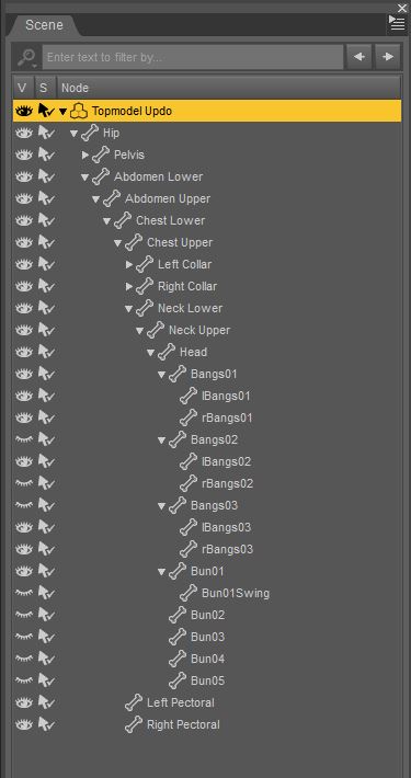

This is just a quick test I did, so there might be other figures that will give these problems, but you have to test that out yourself.

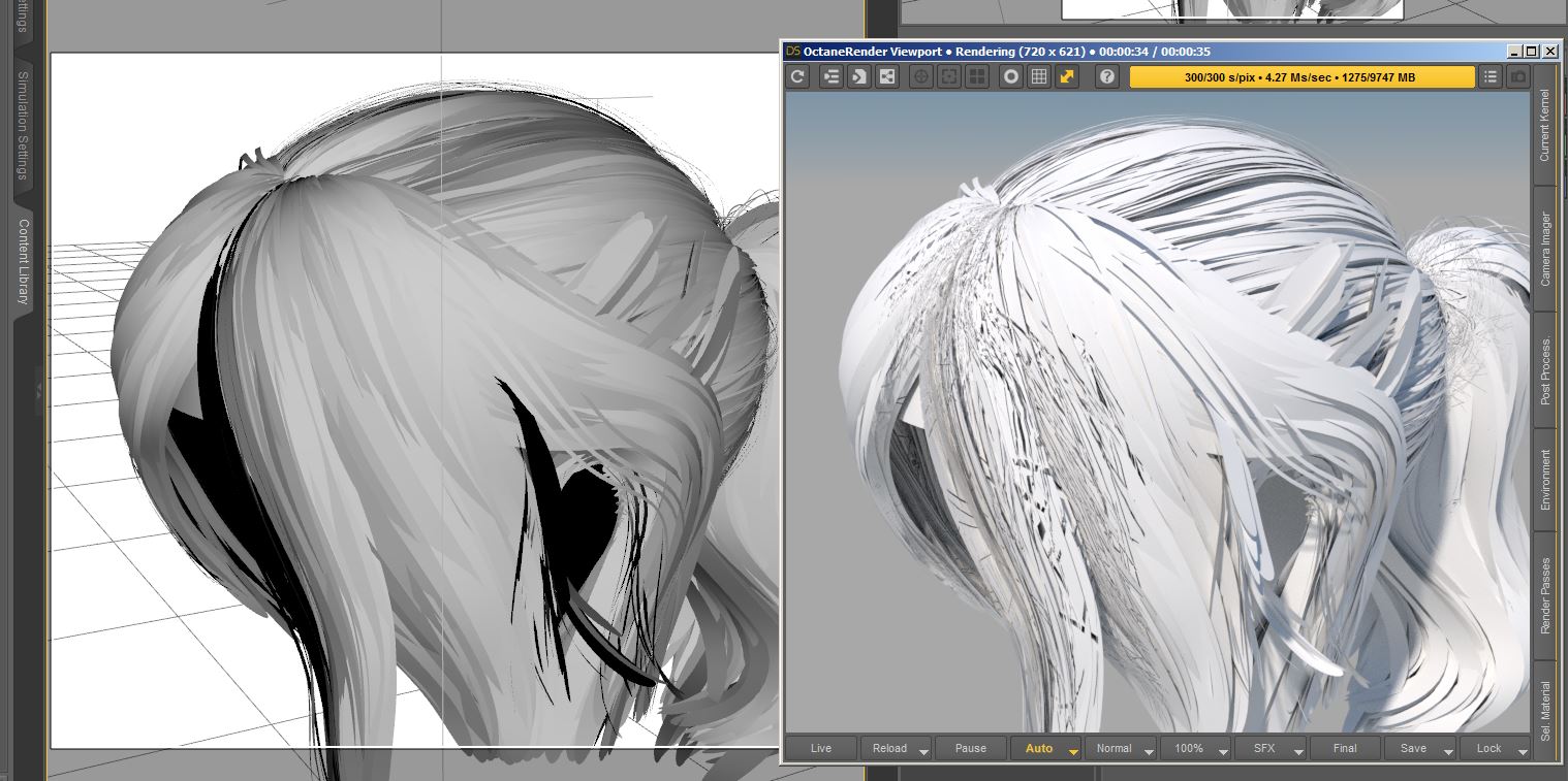

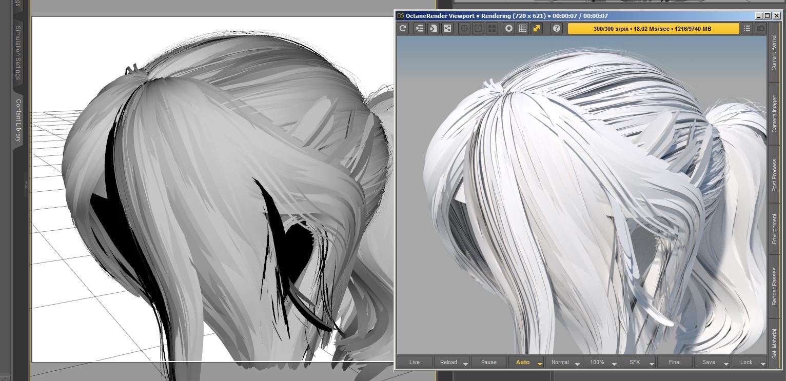

If I load the figure Topmodel Updo Hair, you will see in the scene panel that some of the geometries are hidden. It comes with shape presets so with 1 click these geometries turns on and off. Pretty smart.
But what my test is showing is that these geometries that should be invisible will still load in Octane and have an effect on render times, VRAM, and the known intersecting problem.
To compare I exported the hair out as an OBJ file and imported it back into Daz. Both are rendered without textures and materials with the same rendering settings.
First image is the hair loaded from Daz's content panel.
Second image is the imported OBJ of the hair.

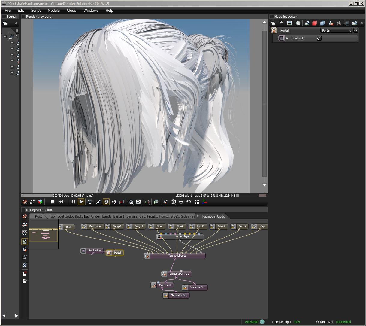

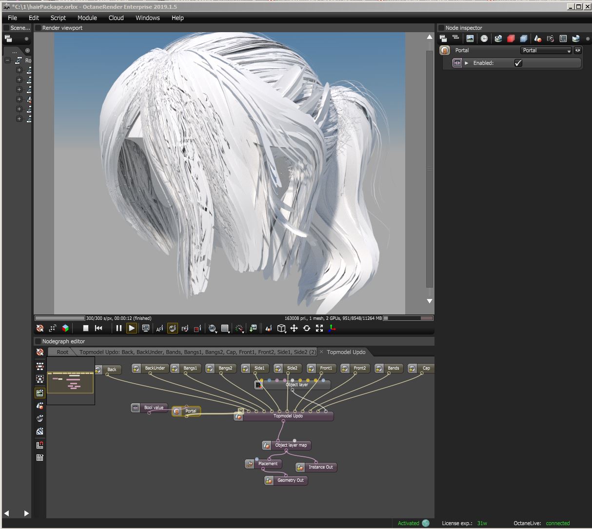

Upon further investigation, I exported the hair to an orbx file to study the setup in Octane Standalone. This just confirms that the extra geometry that should not be there is actually there.
It's weird as it has a portal to hide the geometry. The boolean value on it has no effect. But if you disconnect it from the mesh, all the "hidden" hair becomes visible.
