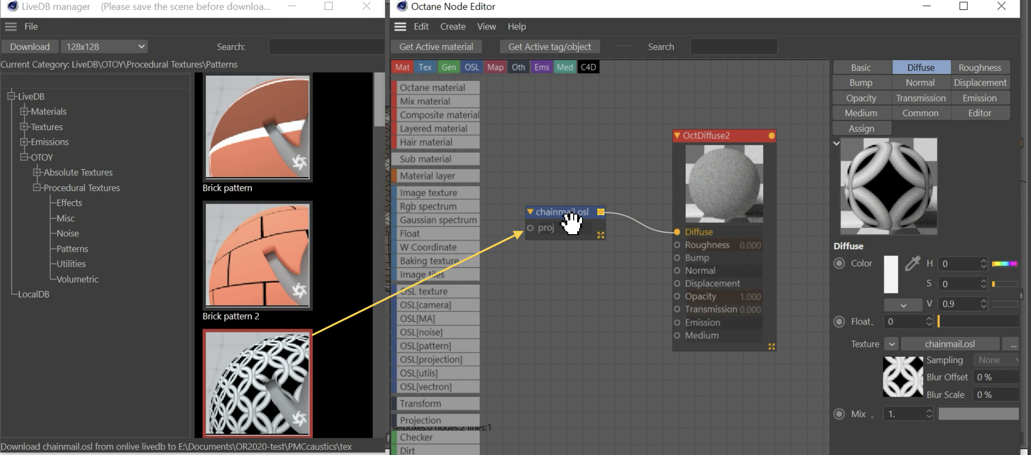

Posts: 10648
since they are Textures nodes, not Material nodes, they cannot be download like a Material in the Material Manager, but you simply need to drag and drop them in the node editor of the desired material:
ciao Beppe

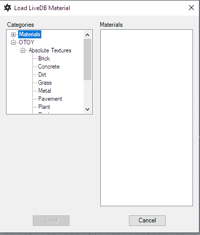

Hi Beppe!
Why I can't see the procedural textures inside the live db?
thanks,
Roy
procedural live db.PNG (7.89 KiB) Viewed 3711 times
Posts: 10648
Have you tried to click on the "+" icon to open the Absolute Textures section?

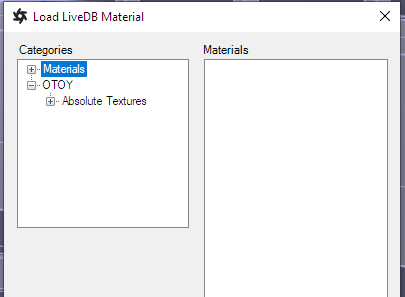

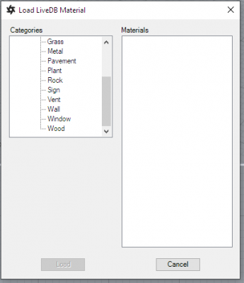

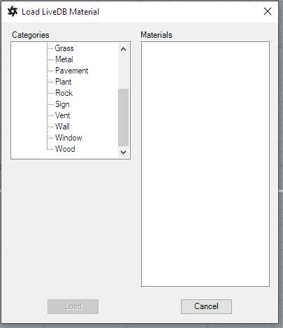

A.Lopez
Posts: 60
Joined: Fri Jan 21, 2022 4:20 pm
Ciao Beppe!
Yep!
nothing appears...
live db 00.PNG (11.08 KiB) Viewed 3704 times
Posts: 10648
You need to select a category, but at a more close look, it seems that the Procedural Textures section is missing in your plugin, you need to report this to face_off
