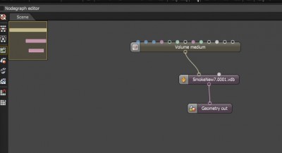

- Did not know how to add the Volume Material. ( I think it would be good if you could post a screenshot of that graph too). In the end I added a volume material (see attached image)

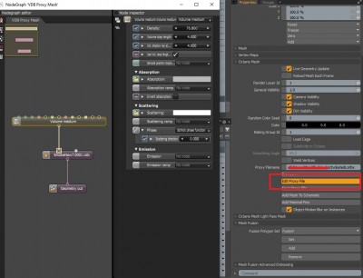

- Did not know how to alter / modify the Volume material inside of Modo. But I found out that the "empty" Item that loads the OrbX proxy has an option "Edit Proxy File" ...which opens the Standalone Graph and that's where I was able to change look (density etc) of the Volume. (please correct me if thats not the right approach)
That is the correct way to do it. I will amend the forum post to reflect this.
Yes, again, you have it correct, and I will amend the forum post accordingly.
