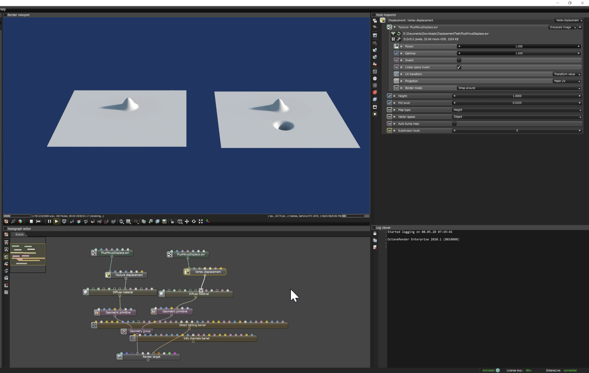

you need to use the new Vector Displacement node, instead of the old Texture Displacement node:
The Vector Displacement can be used with procedural textures, but also with image textures in Height mode.

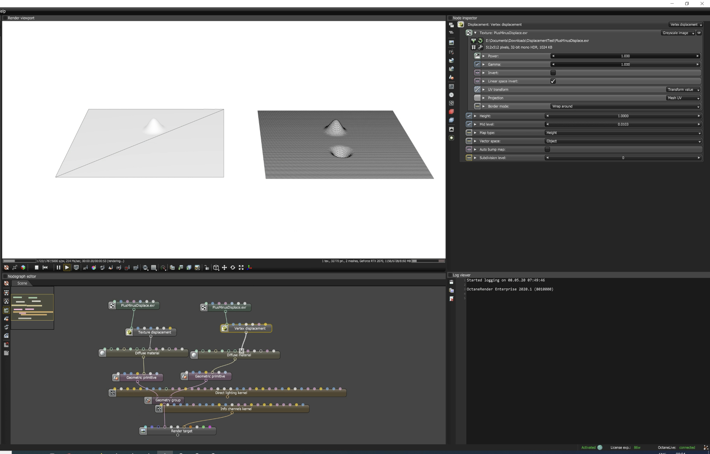

Take a look at the difference in wireframe mode, the old displacement does not need subdivisions, but has some limitations, like negative values or tiling, while thenew displacement works with subdivisions, and does not have those limitations:

Thank you for your help @bepeg4d and @Lewis. The Vector Displacement was something I tried but I figured I was not using the node correctly. It seems like Vertex Displacement is more sensitive to your texture's input gamma, which must be changed to 1.0 to work correctly. As far as I can tell the gamma setting on your texture node doesn't affect the old displacement. But it is working now!
