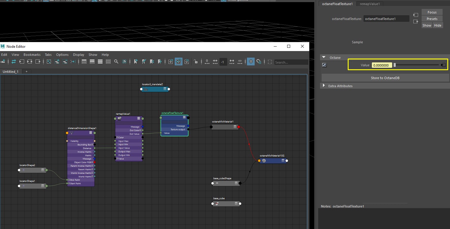

Thanks for this release :) , there is a bug (or maybe feature missing) on those plugs is when we export orbx some constraints connections is not being baked basically each time need bake all those constraints manually , for example the Pascal script for the sun direction. and also when we plug float information drive by maya to drive float or octanes node please check here some screen shots and the maya scene.
Cheers
JO
Sun_shader_keys_test.orbx
orbx exported
(91.63 KiB) Downloaded 264 times
Sun_shader_keys_test.rar
Maya scene
(10.15 KiB) Downloaded 226 times
Custom connection not exported on orbx
Sun script connection not exported
