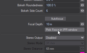

Hi Juango I hope you are fine!...
Would it be possible to also have pick focus in the Octane IPR window for Lightwave as it exists in Houdini's IPR window?
Thanks...
Carlos Caldeira
juanjgon
Posts: 8867
Location: Spain
This feature is already available in the LightWave plugin, but you need to enable it from the camera node.
Thanks,
