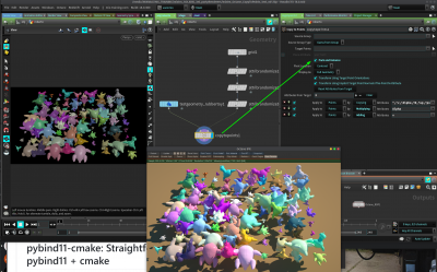

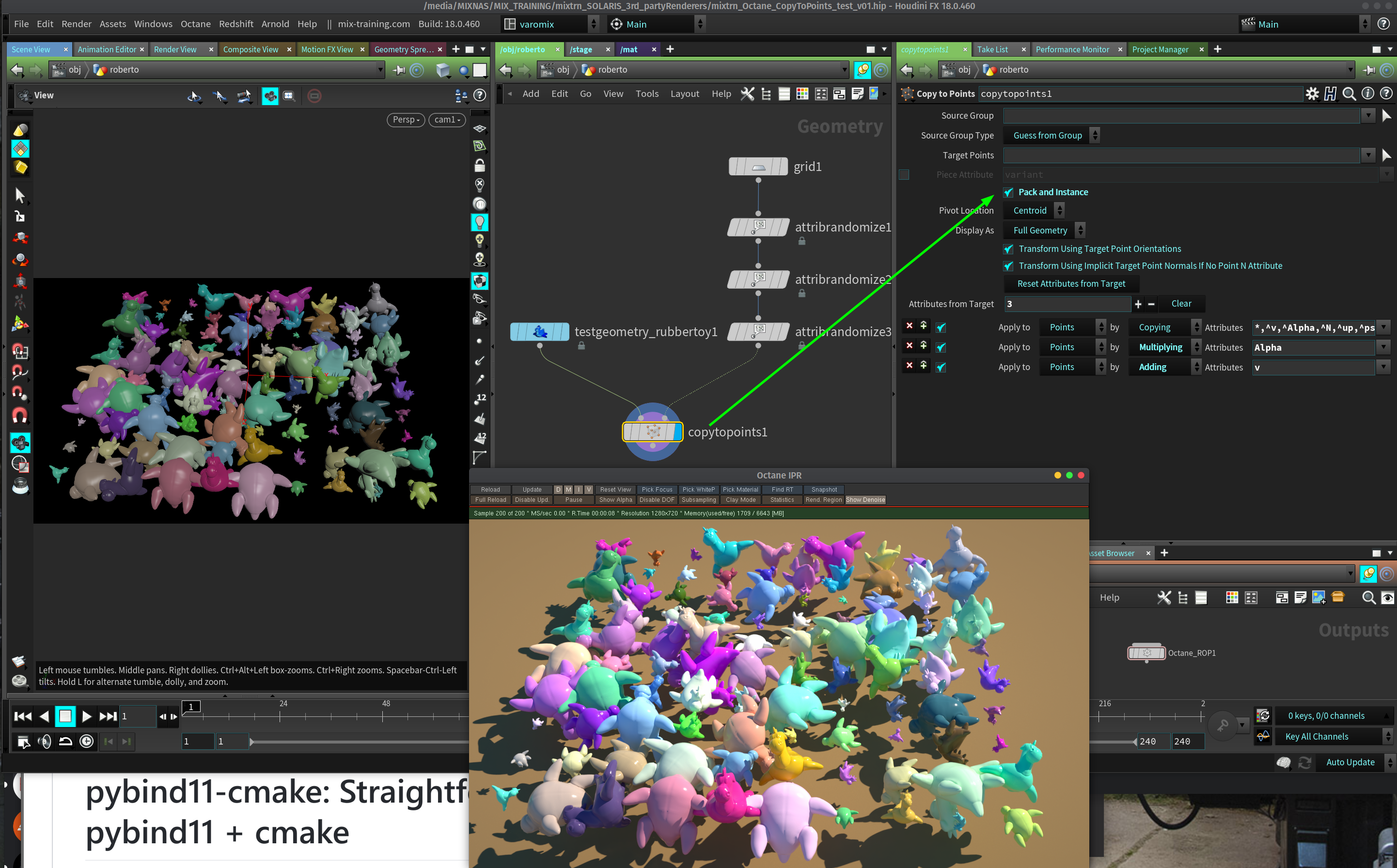

varomix
Posts: 1
Joined: Tue May 24, 2016 7:34 pm
Hi Juanjo
I've been using the copy to points with the Pack and Instance option and it seems to work fine
are you saying this aren't Instances to Octane at render time?
instances
instances
thanks
juanjgon
Posts: 8867
Location: Spain
Yes, in you scene the packed primitives are fully expanded to mesh geometry. They are not instanced at all.
Thanks,
-Juanjo
