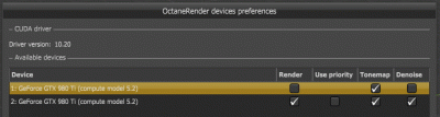

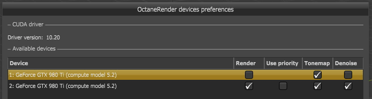

I just purchased the studio subscription, but I can not use the 2 GPUs. When I select the second GPU it will show a cross for some milliseconds, but not a checkmark.
What is the problem?

Hmm I had also download another Octane Server. Now I can use 2 GPUs.
