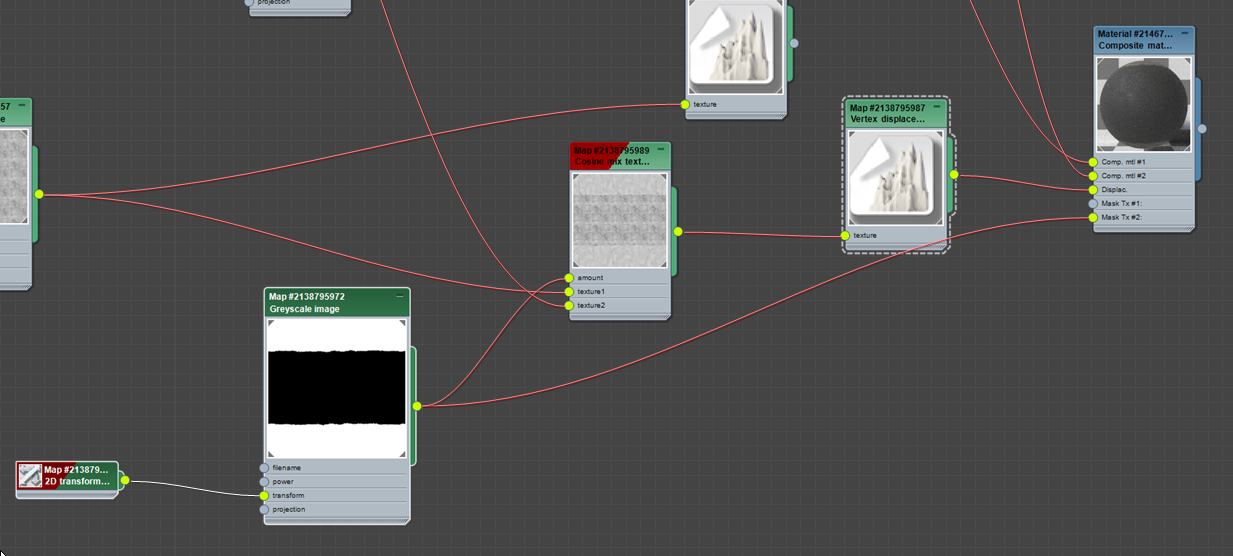

Hi guys,
I'm making a street, I like to compose several layers, with the asphalt, then the tracks and so on.
But I have some difficulties.
I bumped into this problem using Vertex Displacement.
I have try multiple ways.
Rik
Posts: 423
Joined: Wed Jul 28, 2010 8:57 pm
Does it work with texture displacement instead of vertex displacement?
I gave up on vertex displacement and had to just use old school displacement, once I'd found it after they'd renamed it as texture displacement. :roll:
samsue
Posts: 393
- Displace mixer don work with direkt link with Composite material.
- Leaving the displacament only in the sub-material, it doesn't work either.
- I tried to use baking texture, to make 1 map only, but I have probelma with UV that way.
