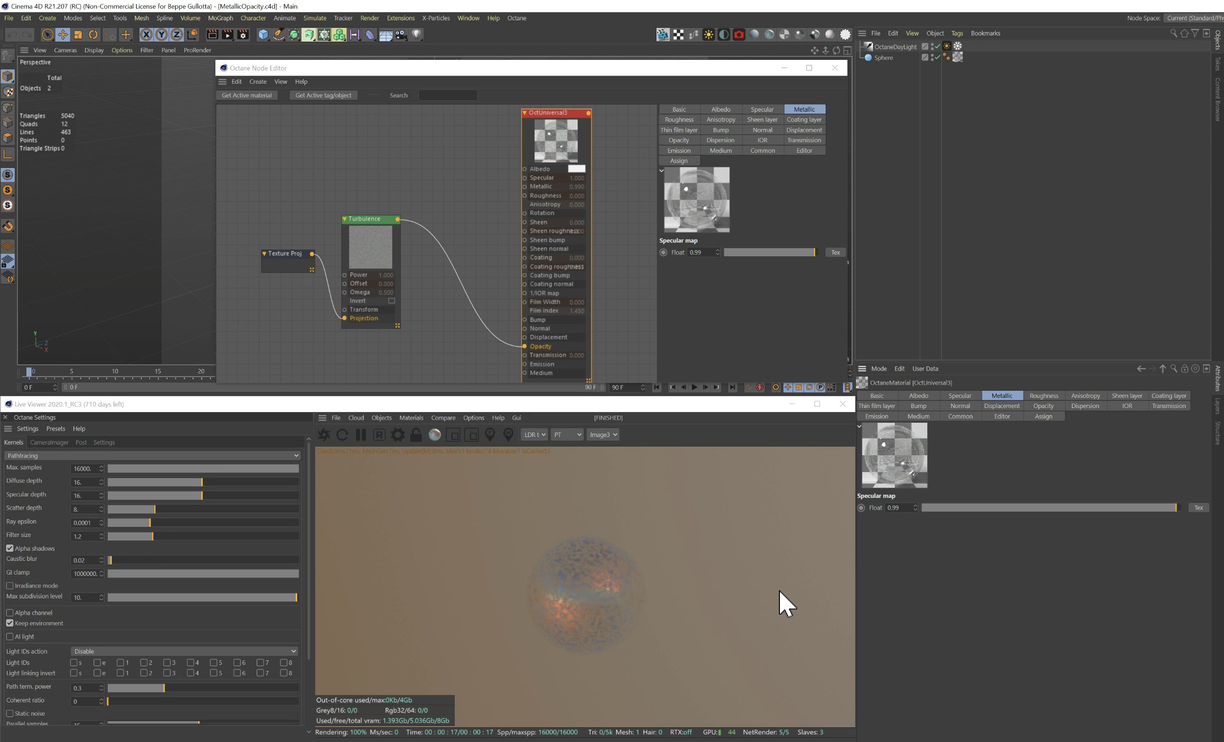

Hi Ahmet,
Opacity channel still doesn't work in conjunction with metallic materials or metallic channel in universal shader. This is breaking some shader setups.
I reported it earlier:
viewtopic.php?f=85&t=74130&p=379286#p379286
I tried to attach a scene but for some reason c4d extensions are no longer allowed. Either way this is easy to reproduce through the following steps.
1. Make a Metallic or Universal shader (with Metallic channel set to 1)
2. Set Opacity float to 0
3. The object will still be visible

the issue is affecting both Universal and Metallic material, you need to set the Specular/Metal map at 0.999 to see the effect.
The core devs are investigating the issue, and will be fixed in the next version.
