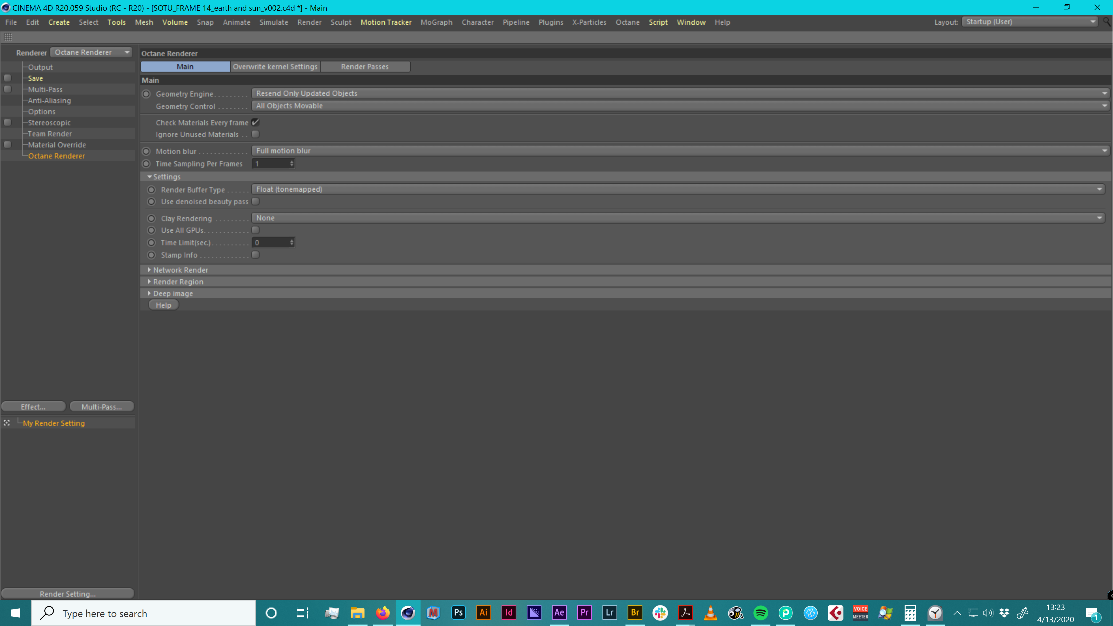

Please, post a screenshot of the Camera Imager panel, and of the Render Settings Octane Main tab, thanks.
Probably something is not set correctly.

Oddly enough that scene seemed to magically fix itself when I reexported. -- Attached is a screenshot of the Camera Imager and the Render Setting Octane Main tab for the project.

I cannot repro it. It's like using Linear render buffer in rendering, not a spectral shifting. Maybe a parameter initialization problem with your c4d and plugin. Play with tonemap types in render settings. Also give a try with latest 2020.1 build.
