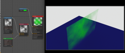

Sure, just use a Dirt Map and multiply it with the transparency.
Blend intersection with dirt
