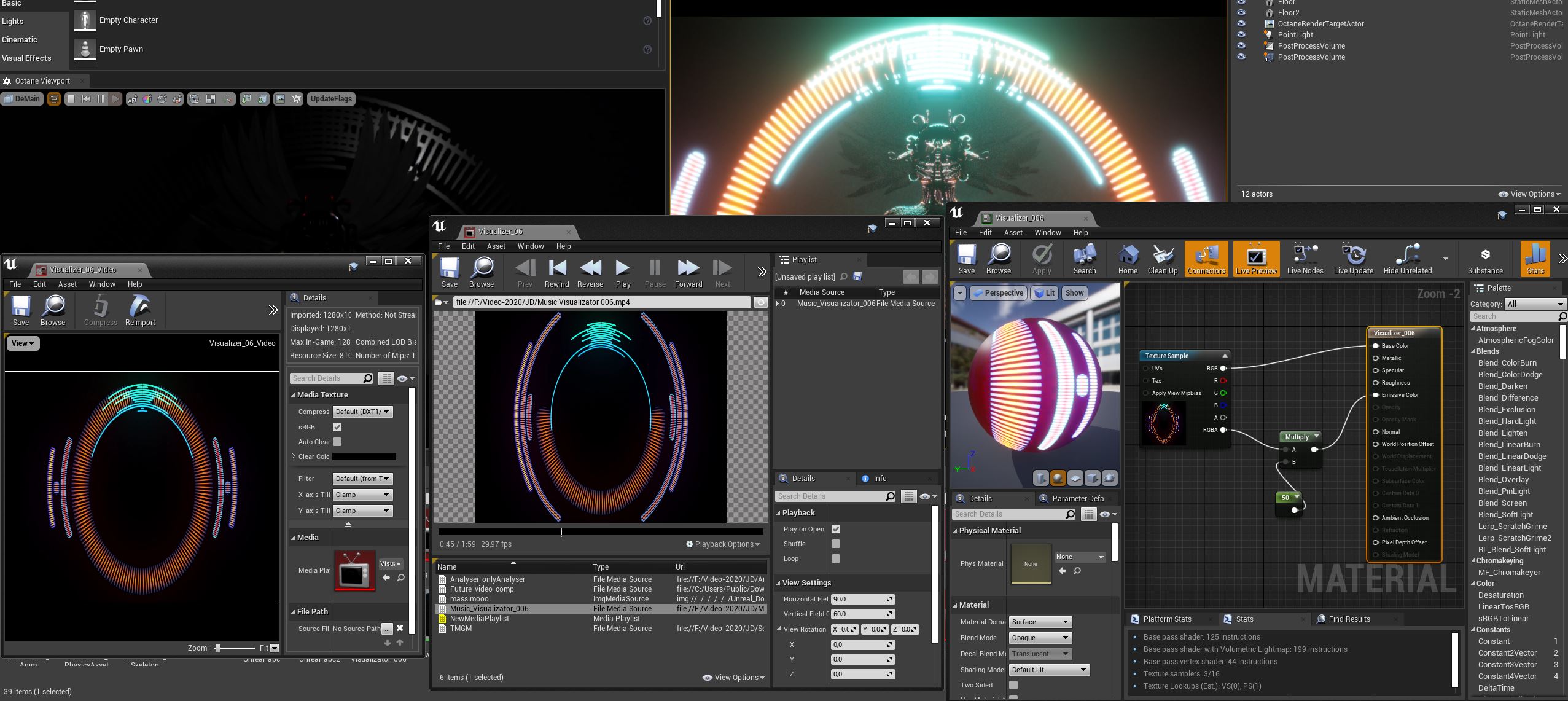

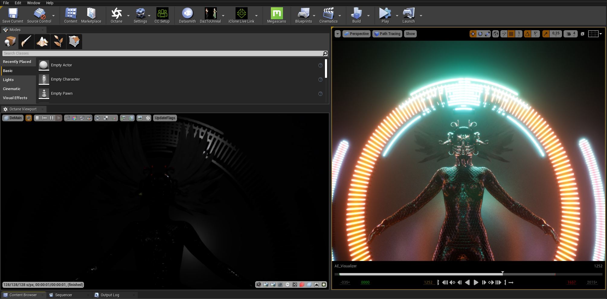

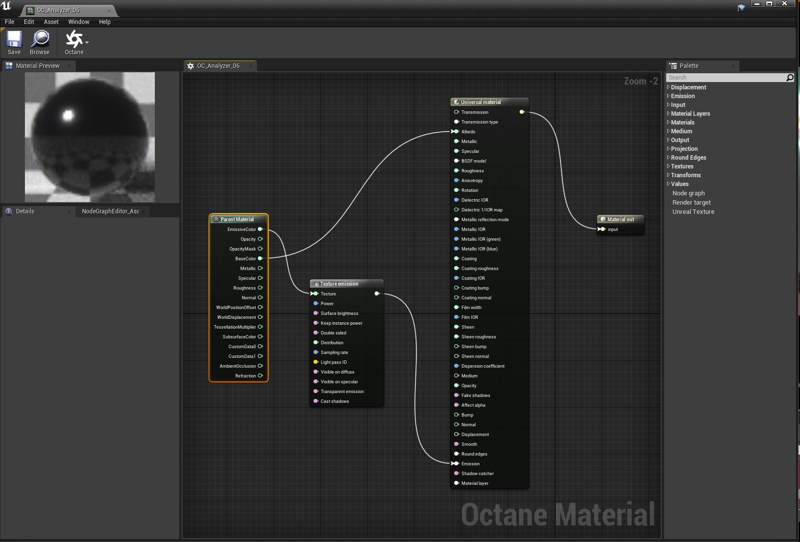

Another question :
Is it possible to render Media Files (Media Player , IMG Media Source) files with Octane ?
I am doing a project with a lot of animated emission materials , all is working fine in UE4 , but I can't get it to render in Octane Plugin.
Or am I doing something wrong ?
Here are my settings :
thx for your hard work !
ChrisHekman
Posts: 1142
Joined: Wed Jan 18, 2017 3:09 pm
StyleMarshal wrote:Hi Chris ,
hope you are fine.
Another question :
I take it this uses unreal texture streaming? This isnt supported atm, but is on the todo list.
