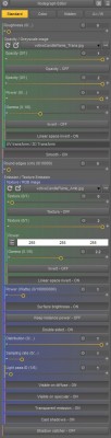

As you can see from the image here .. I've got this problem where the light of the candle flame in the reflection on the water is showing the whole model for the emissive part .. and ignoring the fact that there's an opacity cutout that SHOULD be blocking this from happening. As you can see on the flame itself this is working .. but here's the question?
How the hell do I get the reflected image to behave itself?
I have tried connecting the opacity cutout to the distribution node on the diffuse material .. and whilst this sorts out the reflection .. it screws up the emitted light.
Any thoughts?

I've tried everything .. nothing cancels out the relfection .. other than hooking the opacity cutout to distribution on emission node.
Only other thing is to turn off 'visible on specular' .. but then it just gets rid of it entirely .. and the glow against the wall.

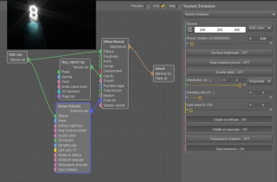

Hmm... that is odd... What version of the plugin are you using? I just did a quick and dirty test and it appears that for me it seems to be working as intended. So perhaps it is a bug? Although I'm still using version 4.4.0.44...
The setting that should be responsible for the reflections is the "transparent emission" node.
In my test scene the light is a simple primitive plane with texture emission surface attached to it and a greyscale opacity map assigned to the diffuse material - as seen on the attached screenshot. For catching the reflections I'm using again a simple plane and a cube with specular materials (medium/absorbtion pin enabled in case of the cube).

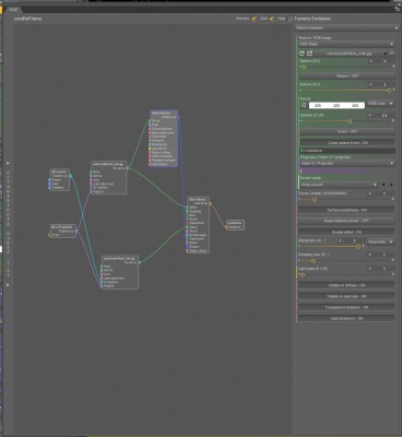

Here's how my Nodes look for this:

Hmm .. Okay I turned off Transparent emission .. and now the reflection is working as it should.
The reflection against wall is a LOT less .. so that's kinda bum as I didn't want to lose this .. but then I guess the reason why it was casting a nice big glow was because of the size of the flame model.
Okay .. well it looks like this actually is working then .. I guess I must have just not used this before because it reduced the overall emission light.
