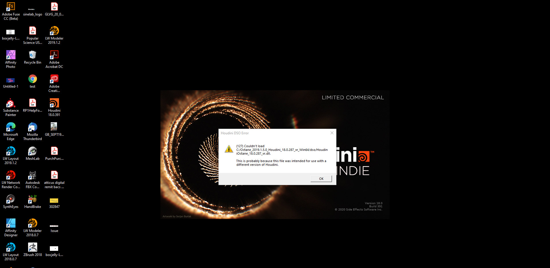

I've been using the Octane plugin for Lightwave for a while and I have the full enterprise subscription for the year.
I recently got a indie license of Houdini and I'm a total newbie. I was wondering if I can use the enterprise version with Houdini or would I need anything else ?
I tried installing octane following a video by OTOY but I'm getting an error (see attached) the version 18.0.287 was the only option in downloads, any one got any ideas ? thanks in advance
Octane install issues
Moderator: juanjgon
If you are working with Houdini 18.0.391 you need to use the proper plugin build for it. Please, check the releases subforum to download the latest 2019.1 or 2020.1 builds that include plugin builds for the latest Houdini production releases.
