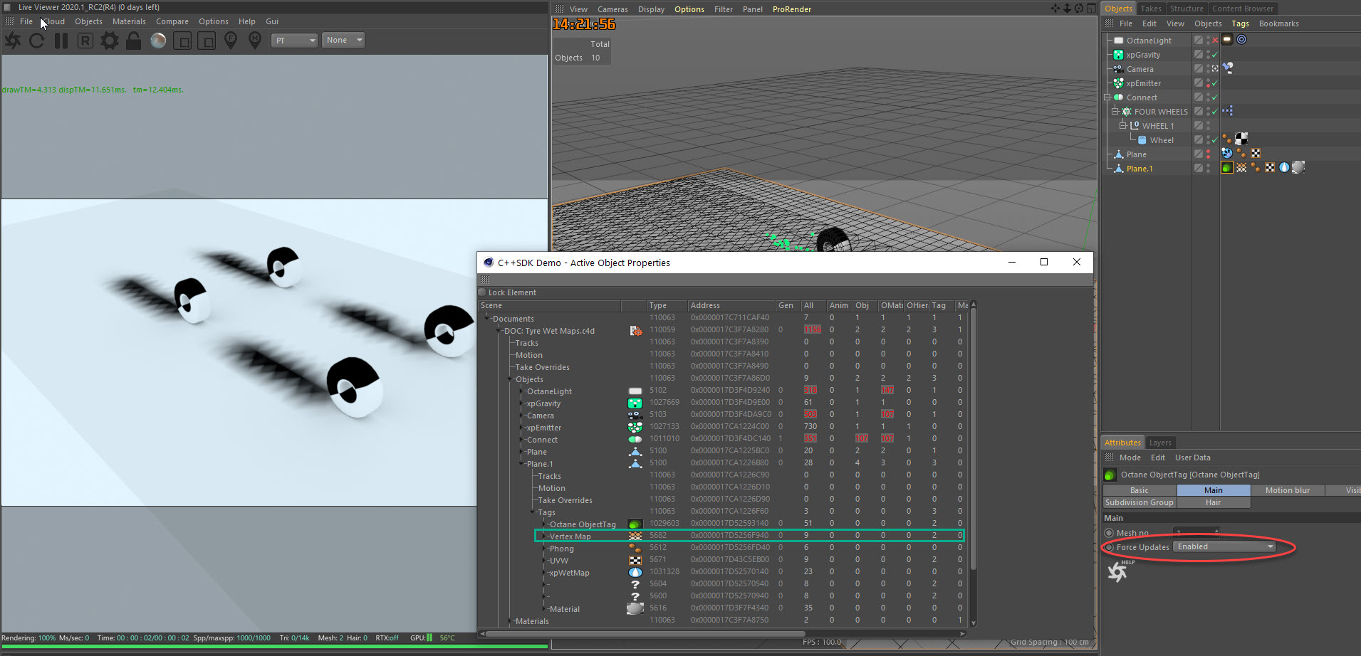

For answer check the picture. There's not any dirty flags in vertexmap to detect the changes. As a workaround, use object tag with "force updates". Then it will update the mesh for every new frames.
The true solution is that the xpWetMap should trigger a flag in vertexmap.
