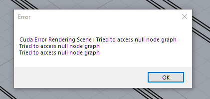

Hi Roy,
it seems that the osl script has been loaded as an osl texture, not as an osl projection node
Did you load it in a Projection node in OSL projection mode?
Try to save the material in Standalone, then import back in Modo via LocalDB, does it work in this why?
