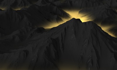

For instance Modo can achieve something like this quite easily and I can think of a lot of instances where displacement depth would be a useful driver for a color gradient. in this instance emissive intensity is also driven by the same gradient

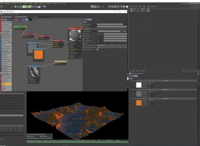

Posts: 10533
have a look at this solution that uses the Displacement texture to drive a Mix texture node in Diffuse, the Gradient helps to fine tune the position and the contrast:

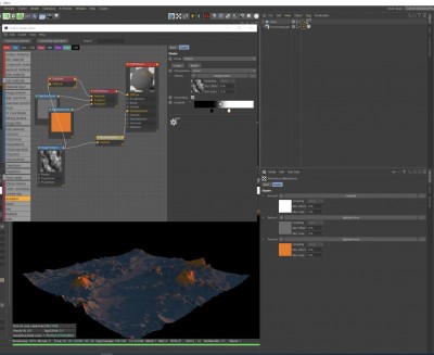

and here is the solution with Dirt texture node to drive the same Mix texture node:
ciao Beppe
