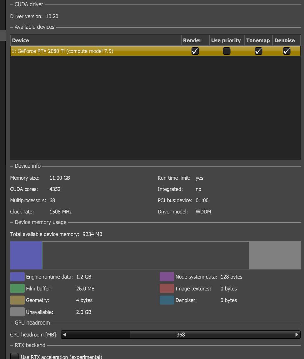

I see an Optix message, do you have RTX on?
You can check how much vram is available by going to the octane GUI
go to "File", select preferences.
Then go to devices.
Could you tell me how much is still available? (preferably share me a screenshot of your window)
*Make sure you have activated rendering by pressing render on a rendertarget.
The window should look like this:
Then go to devices.

CPU memory is an option in the the out-of-core tab under the devices tab.
Just to be clear, the above picture with 1.2 gb of engine runtime memory is in Octane for Unreal Engine.
And the picture of 6.21 gb of engine runtime memory is in Octane standalone?
Not sure what you mean by "import an octane scene and work from there"

Wow! Reducing the parallel samples fixed it! The memory usage is way down because of that too. Thank you so much! (Also could you explain what parallel samples is exactly?)
This was the issue: When I start a blank file and have Unreal create a Rendertarget node for me, parallel samples defaults at 16 and I can't render.
When I import an ORBX scene, the render target node was already made, and parallel samples was set to 8. That's why I could render stuff when I imported an ORBX scene into Unreal but not when I started from the Blank level.
Both of the pictures above are in Unreal. The top one is when I start from the "Blank" level, and the bottom one is when I import an ORBX scene and load that instead.
Thank you again!
