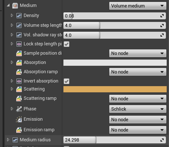

Its the "medium" item. This creates a volume around the camera that can do scattering. The "medium radius" determines the size of this volume around the camera.
When you create a new volume or scattering medium node for the environment, dont forget to set the scattering color to get scattering.
Example:
Another way is to create an actual fog material. Simply place an unreal box
Create new octane material, place it on the unreal box.
Open the octane matieral and add a specular material node, attach it to the output, and then add the same volume material as in the example picture above.
