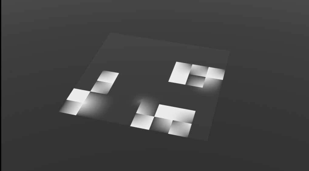

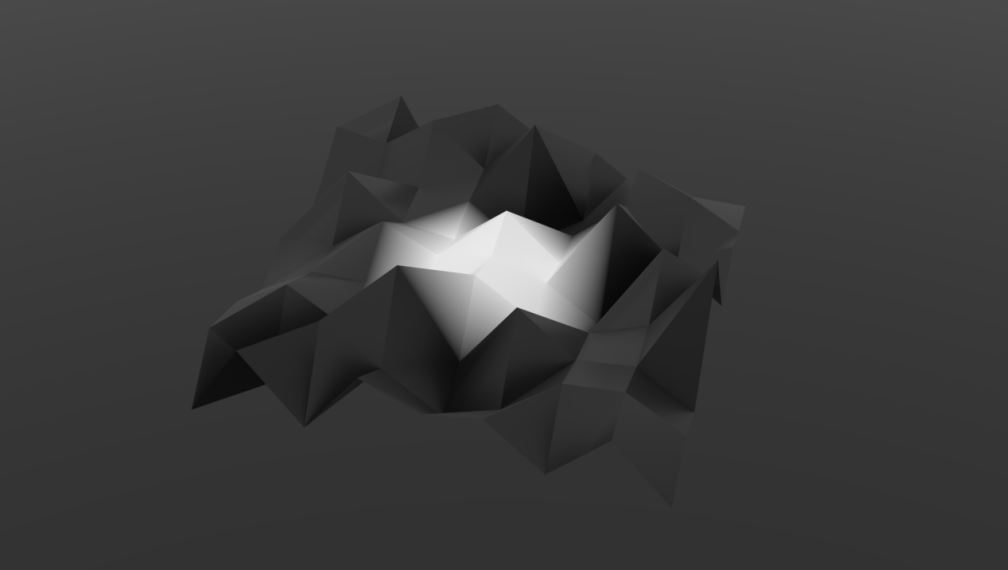

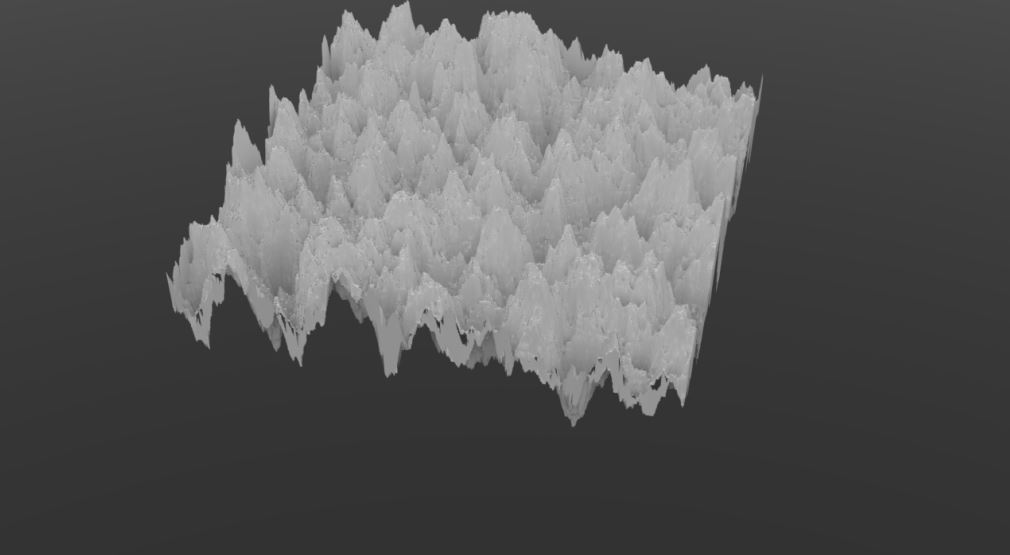

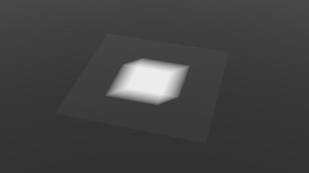

Hey Paul,
i have some issues with vertexmaps:
-Using a Vertexmap with a Texturedisplacement does not work
-Ticking Load Cage causes the VMap to mess up
-Using a VMap with the Displacementmixer does not work
Maybe you can look into this
