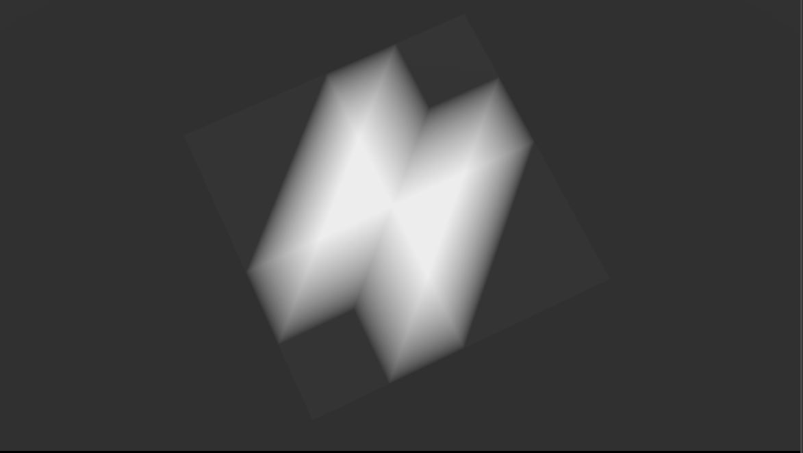

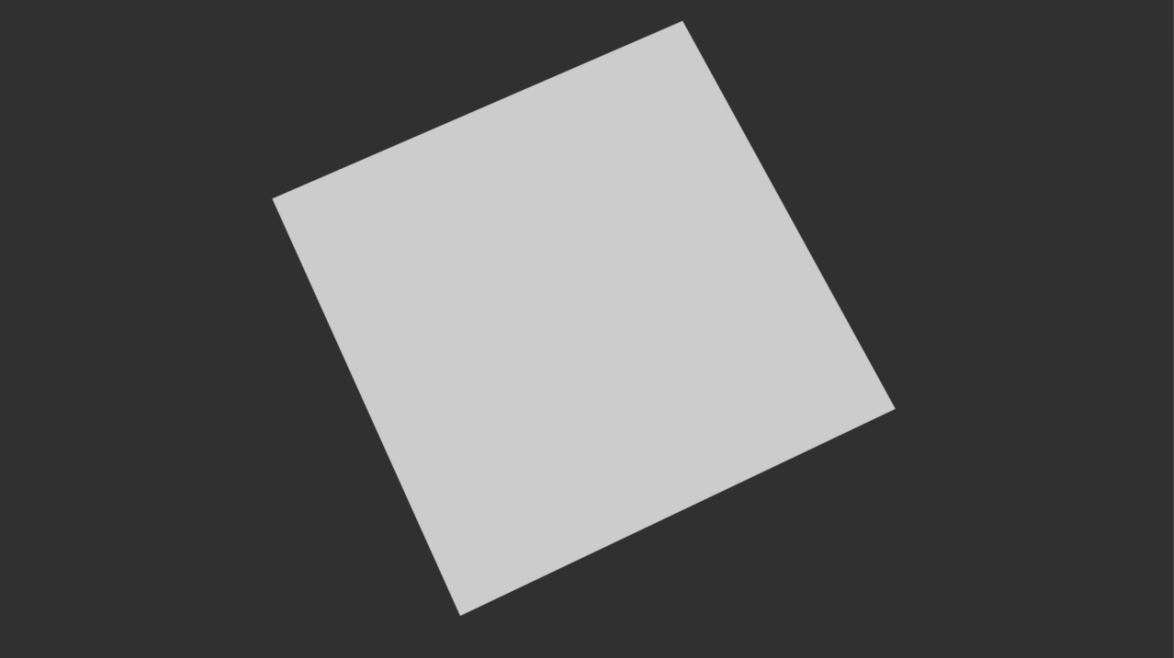

Hey there i want to use Modos Fur and a vertexmap at the same time. Building the Shader Works finde. But when i enable Modo Render Cache the Vertexmap stops to work. Is there a way around this?

Rendecache On
Rendercache Off
Here you are. VMaps don't work if the rendercache is enabled

Thanks for providing the scene. I can now confirm that unfortunately the Modo Render Cache does not provide Vertex Map textures or weights. I suggest submitting a Feature Request to Foundry for the to add this.
