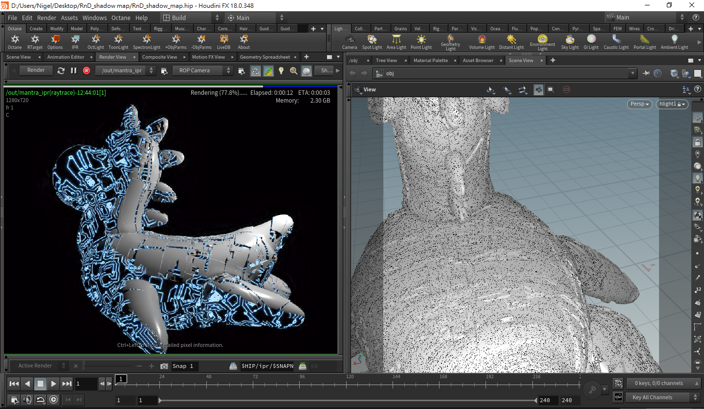

I use the specular SOP to make a Backlight Light FX in mantra, may I know how can I do the same FX in Octane
D__Users_Nigel_Desktop_RnD_shadow map_RnD_shadow_map.hip - Houdini FX 18.0.348 13_3_2020 12_44_14.png
D__Users_Nigel_Desktop_RnD_shadow map_RnD_shadow_map.hip - Houdini FX 18.0.348 13_3_2020 12_40_30.png

Hey that's a nice effect ! Maybe look into using the "mix material node" with a " polygon side " node as switch input . That way you can use a opaque front side material and a self illuminating( emissive ) back side with transparency for the pattern you've created .

WoutTgh wrote:Hey that's a nice effect ! Maybe look into using the "mix material node" with a " polygon side " node as switch input . That way you can use a opaque front side material and a self illuminating( emissive ) back side with transparency for the pattern you've created .
that's no really work, this FX is only illuminating on the shadow, so if I light up the environment, the illuminating FX probably all gone (maybe some will let on shadow)
