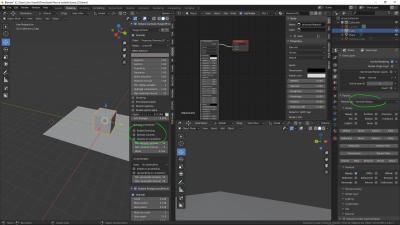

Sure, I've left only a plane and a cube in the scene, deleted everything else but it still does not start rendering.
Without the log telling what is wrong it is difficult for me to understand what needs fixing.

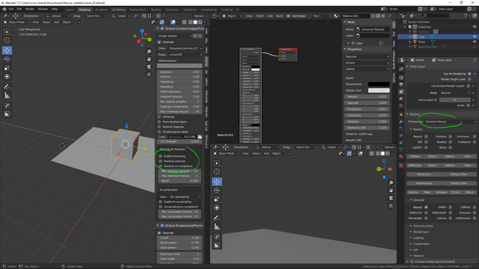

acoval wrote:Sure, I've left only a plane and a cube in the scene, deleted everything else but it still does not start rendering.
Scene Included
You have the wrong pass selected (Denoiser Beauty). Since Denoiser is not enable, you should set the preview pass to "Combined".

Thank you , this worked!
Guess this is a bit of an alien concept to me in Blender , when switching off a simple feature like Denoising stops the rendering completely.... very unintuitve.
