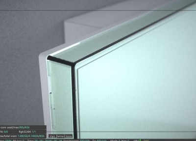

Hello to all,
I have a trouble with transparent material.

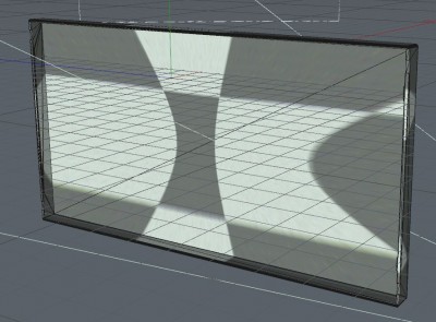

I drawn a cap with 1mm thickness
Black lines appears in the thickness by transparency, it makes it unrealistic,
I tried everything I had in mind (redrawn a similar volume, uncheck fake shadow, flip normals, change environment, diffuse and specular depth, use pmc and pathtracing)
Do you have any Ideas that I mess, please ?
Thanks a lot,
frankmci
Posts: 917
Location: Washington DC
1 mm is pretty thin. The first thing I'd check is Ray Epsilon in your Kernel settings. It is a scene- and object-scale sensitive attribute.
bloodyriton
Posts: 23
Joined: Mon Mar 31, 2014 2:29 pm
You are right, this does help !
Thanks a lot :)
