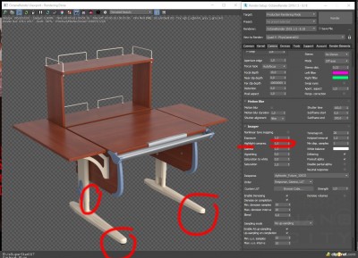

Highlight compres not work
Elvissuperstar007
Posts: 2607
Location: Ukraine
I do not want to include nonliner tone mapping
this function worked fine before, now it doesn’t work, return this function

I’m having the same issue in 2019.1.5-8.19 Doesn’t seem to work. Any ideas?
paride4331
Posts: 3991
Linear Gamma doesn't allow highlight compression, if you want use it please check "nonlinear tone mapping".
Regards
