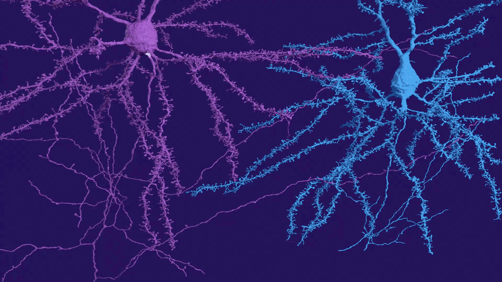

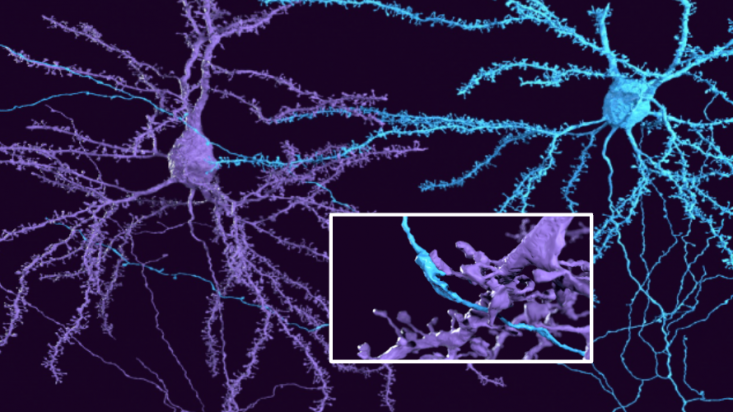

I'm working on an animation that will show an impulse moving from one neuron to the next for our lab. The neurons in the model were reconstructed by AI from electron microscopy image stacks and the meshes are garbage. So I remesh in C4D with Volume Mesher and Volume Builder, which usually works fine, but currently when I go to render it shows black and freezes C4D entirely. I've been MIA from C4D for 6 months during maternity leave so it's possible this is something obvious that I've totally spaced on.. Any help would be appreciated! Project file: https://drive.google.com/file/d/1y_jt2d ... X2o4h/view
Below are the neurons I'm trying to show before they were remeshed.
