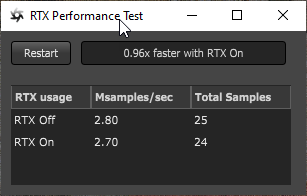

I downloaded the Standalone Octane Render Enterprise 2020.1 RC1 and the OctaneRender_for_Modo_2020_1_0_157_ENTERPRISE pluguin. Both versions render slower with RTX than without RTX activated.
Anyone knows how this is possible?
Could it be that it doesn't work with existing files? That the scene has to be built from scratch?

RTX should just work in already existing scenes.
Can you share the scene you got this results with or a trimmed down version we can use to reproduce it?
