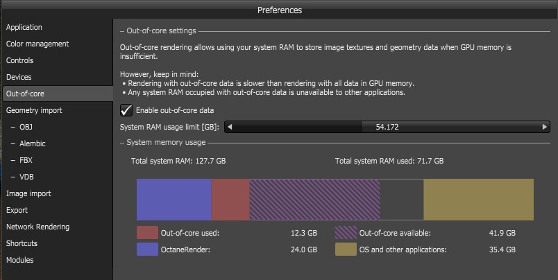

Finally my scene that always had a OOC memory issue since 2018.x is rendering under 2020.1 RC1. It has been a long wait.
2020.RC1 OOC memory usage.

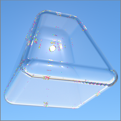

I'm doing some tests with the sun models and noticed there is a lot of noise in reflection/refraction on glass.
I can't find a way to clean it up either.

funk wrote:I'm doing some tests with the sun models and noticed there is a lot of noise in reflection/refraction on glass.
I had a look into this and it seems like it's a general path tracing problem, it's not really good at tracing indirect rays and hitting the sun.
This is because the sun is relatively small compared to the rest of the sky, and so your indirect ray would hit the bright sun with really low probability density, thus the contribution of such hit would be really really bright. This generates bright fireflies on rays that do hit the sun, and coupled with dispersion it generates extra color noises on top of it. The problem is worse for glass due to 0 or little roughness, so there is no direct light to help reduce the variance.
The short term solution would be to increase the sun size and perhaps use a different kernel such as PMC.
