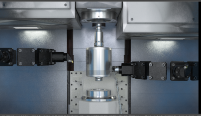

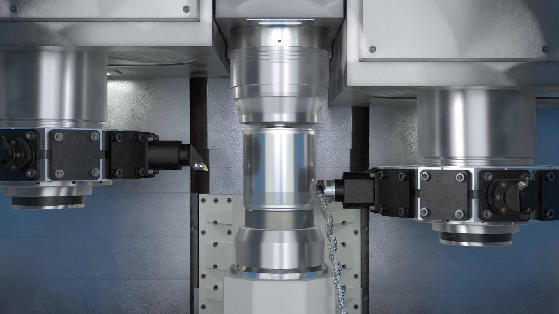

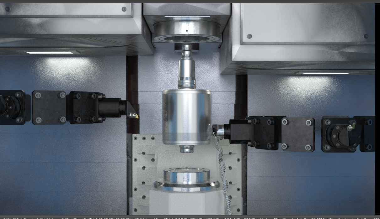

As far as I told, unticked "load cage" making some of animated objects jump away from the required positions, but frame changing time becomes a way faster - you're right! Please, take a look at the pics embedded - one of the renders have the "load cage" enabled, one disabled. These objects are on the wrong place: VT4_Turret_Left (VT4)VT4_Turret_Left (VT4) (2), ColletChuck (VT4), OppositeChuck (VT4) - they're all have a shifted pivot point. I know it's possible to use an old way with locator parenting, but this approach will work too, I think. My version is 2019.1.4.154 Enterprise
Load cage is on
Load cage is on
Load cage is off
Load cage is off

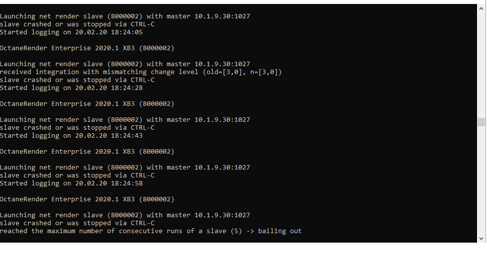

I've tried to use a 2020 x3 version and seems like the problem with shifted pivot isn't exist there, but I met one another - my network nodes refuse to work (screenshot is embedded). I have to reinstall 2019 back in order to proceed with render. B.t.w. why 2020 Octane wrote me, that I have only 7 days of license left (actually, I have more, than 250) - Is it a kind of beta issue?
The 7 day license remaining is an Octane issue, and will be fixed in a future release. Do you have the Octane 2020.1 RC3 installed as the network node? The network node and the Modo plugin Octane versions much match.

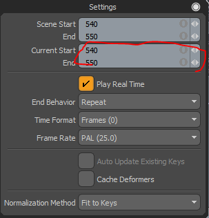

seems like I've found a reason with jumping of objects, that has a shifted pivot. It's happening only if you do a preview of the frame out of current preview range. For instance, if we have a range from 540 to 550, as on a pic below, and we're going to render a preview for frame 1000 this issue will be happened.
Konstantin
face_off
Posts: 15830
Location: Adelaide, Australia
Object Motion blur (and Camera Motion Blur) only works for the current render range, so rendering a frame outside this range is going to get an odd result.
