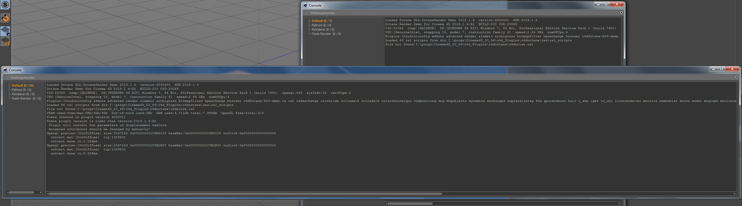

Then, please, go to c4d menu Extensions Console, (Shift+F10), and share a complete screenshot of the panel, thanks.

Hello Beppe,
again thanks for taking the time.
I did as you asked, attached is the screenshot.
The smaller one before loading anything, the larger one after loading the simple scene.
hope that helps..
