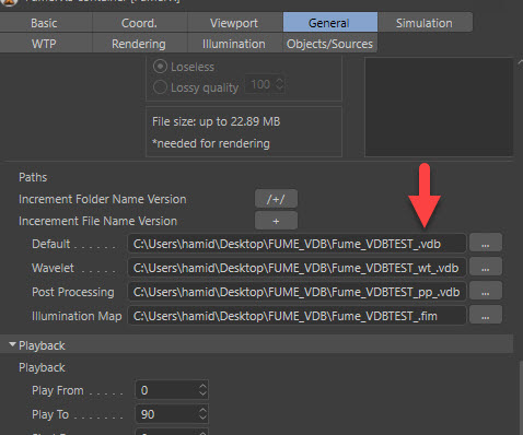

I got some screenshots
First screenshot shows my account.
Second one showsmy file directory. It contains of 90 frames.
Third one shows FUMEfx where i have selected my directory
And the last fourth one shows my settings.
I created a VDB volume. I have selected frame 0 in my VDB directory.
I have 90 frames, should i enter 90 in the end? I tried but nothing happens.
As you can see in the Octane live viewer a small cloud is displayed, but it does not move when scrubbing the timeline and it does not match the actual frame where i should have a very high smoke.

digits=4
this will solve your problem

I did a new sim with only 30 frames. Exported as VDB.
Changed digits to 4.
I start from frame 0 and end at frame 30.
My Cinema4d scene scale were in centimers.
I added the Octane volume and tested it out. I still get nothing.
When i change the import units to hectometers (picture 2) , i do see something when i zoom way back out, but not after frame 9 there i s nothing..
Please advice
