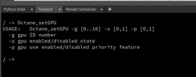

You should be able to render using two or more Octane instances in the same machine with only one license. The GPU settings are set for the current rendering, so you could for example open one Houdini session and render from it using one GPU, and later open another Houdini, select other GPU and also render from it without problems.
You can even configure the GPUs to be used for the current rendering from hython or a script using the "Octane_setGPU" hscript command.
Hope it helps,
-Juanjo
2020-02-02 18_42_16-untitled.hip - Houdini Apprentice Non-Commercial 18.0.348.jpg

Aha nice...
So can this be like pre-render script in octane rop?
Also can this be render command thought hbatch?
I'm having job on deadline that renders frames , it is like this:
hbatch.exe" -c "render -f 155.0 155.0 1 /out/Octane_ROP_ground;quit" "Y:\projects\file.hip"
So i'm asuming command should be something like this:
hbatch.exe" -c "Octane_setGPU -g 0;render -f 155.0 155.0 1 /out/Octane_ROP_ground;quit" "Y:\projects\file.hip"
juanjgon
Posts: 8867
Location: Spain
Yes, the command should work in any case if the rendering has not started yet.
