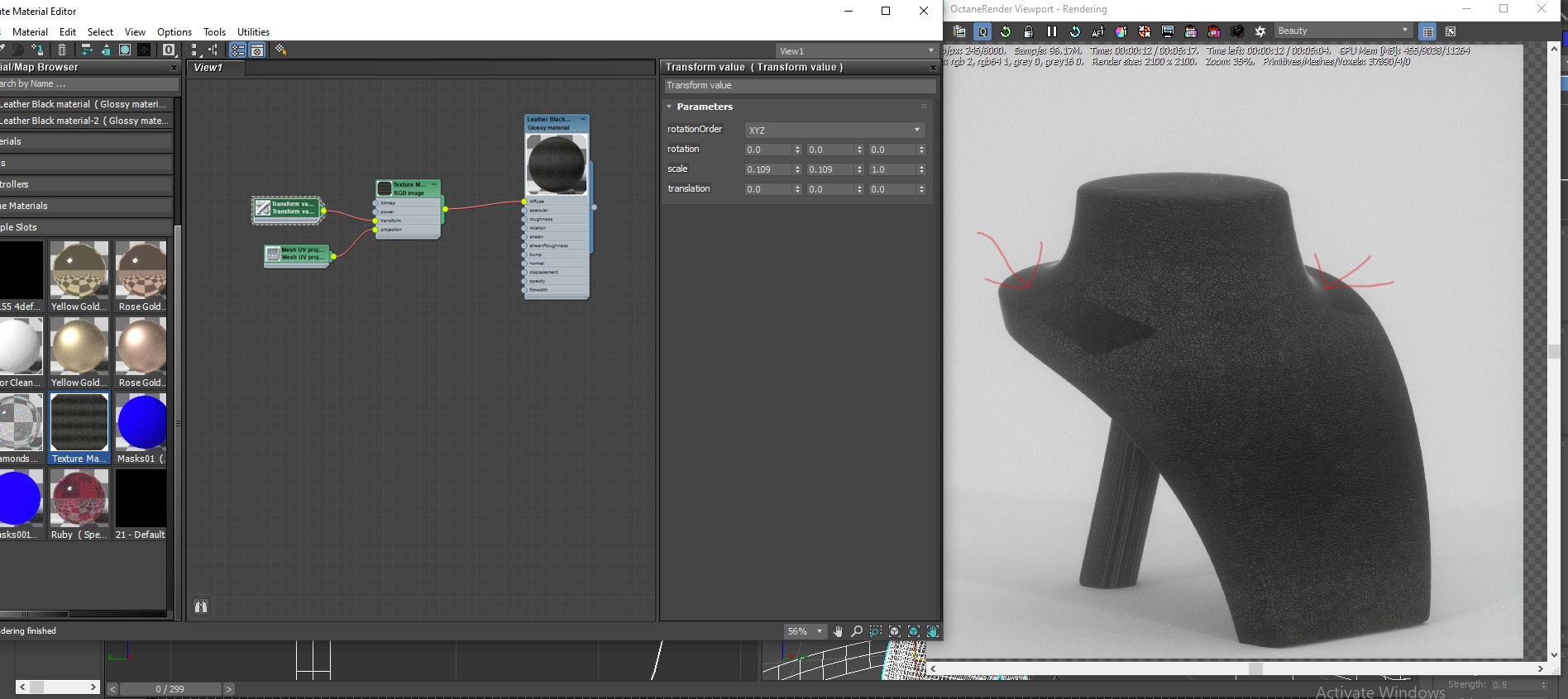

I'm trying to add RGB texture image to my neck models but it's having some seems in some area of the neck model.
I have attached screenshot of it can someone please help. Sorry I'm still a new.
RGB image texture

HI Supun,
it depends on uwv map, not on RGB texture node, you would unwrap the the map.
eventually you can try using the 3dsMax UVW map or the Octane projecton nodes
https://docs.otoy.com/3DSMaxH/3DSMaxPlu ... ctions.htm
Regards
Paride
