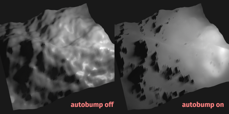

BUG: Displacement autobump seems to break on scaled items
1. Load the orbx and select the rendertarget to start rendering
2. Select the DISP_MAT nodegraph and toggle displacement > autobump off/on to see the difference
scaled_item_autobump_bug.orbx
(84.5 KiB) Downloaded 252 times
