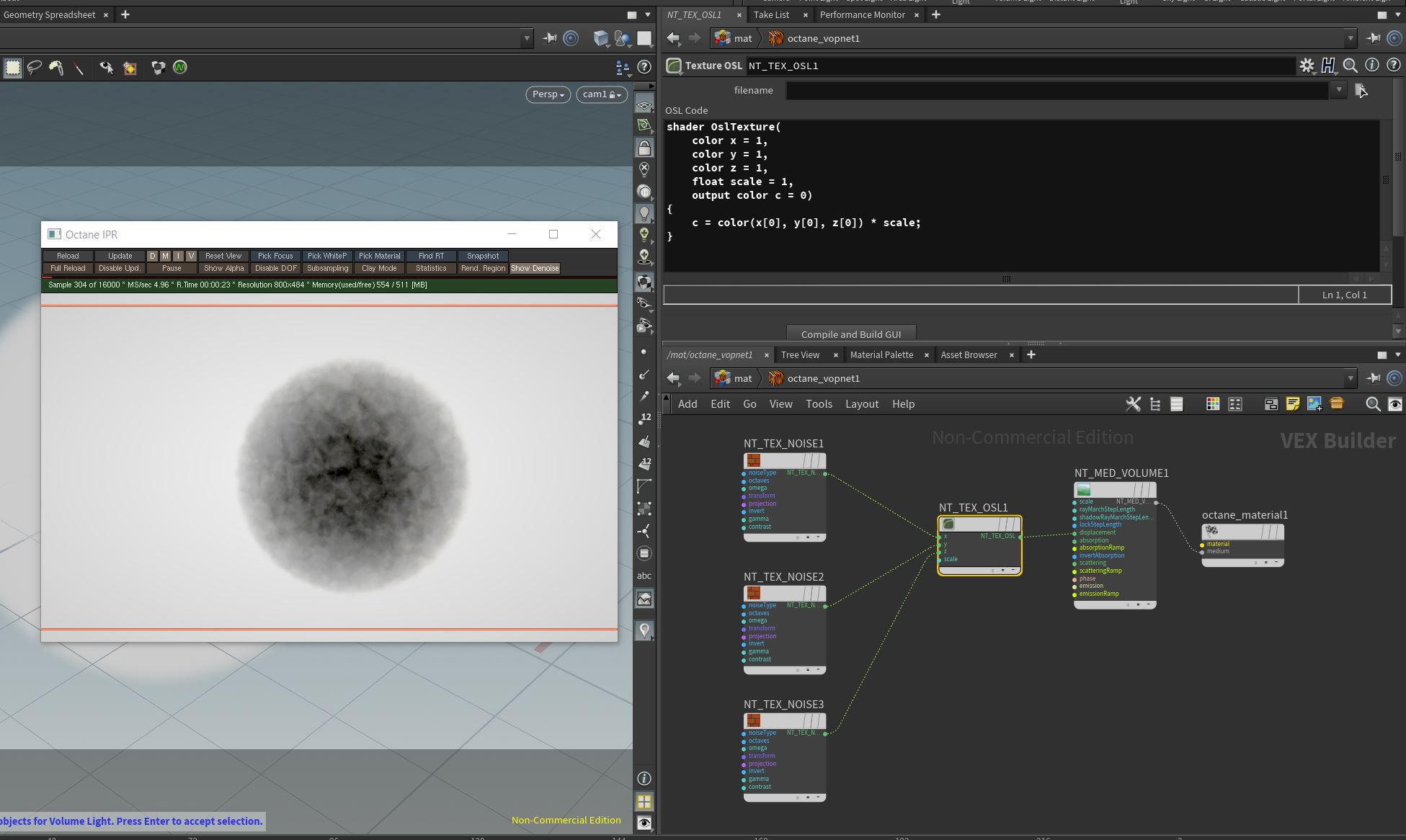

caseyhupke wrote:Where does the Volume Sample Position Displacement node/sop/material live? I'm trying to tinker with that right now, but not finding it in the plugin. I see displacement on the medium material, but I don't seem to be able to drive that with anything i pipe into it.
I think that this feature works from OSL texture shaders only. Check the attached example scene.
Thanks,
-Juanjo
volumeDisplacement.zip
(55.89 KiB) Downloaded 175 times
2020-01-23 22_29_14-E__volumeDisplacement.hipnc - Houdini Apprentice Non-Commercial 18.0.348.jpg
