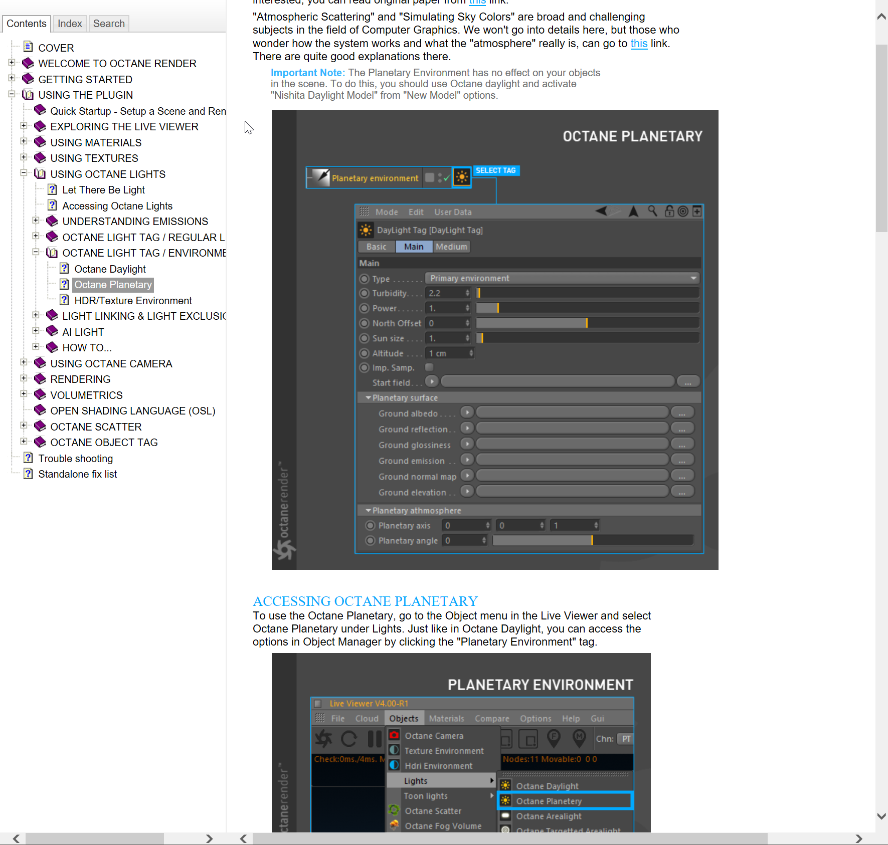

I have just reviewed the documentation, and in the 2019.1.5 build the Planetary Atmosphere turn down is missing as it is presented in the docs. There is an xyz entry field there, along with an angle slider. Perhaps this is the key. The images in the documentation clearly shows the planet off axis from frame center, which is what I want to accomplish. Was there a reason that this section was removed from the shader?

Where did you find it? I'm not aware of any control like that. Did you see it in standalone?

I have included a screenshot of the help contents for the Planetary environment in the attachment. I got to this when I clicked on the help icon in the daylight tag of the planetary environment. Thank you for looking into it, Ahmet, I appreciate it.

I cannot remember it. But It's not available on any recent versions of standalone. Probably removed in a version some times ago.
