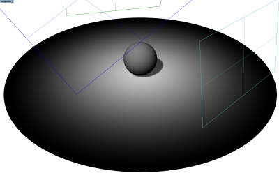

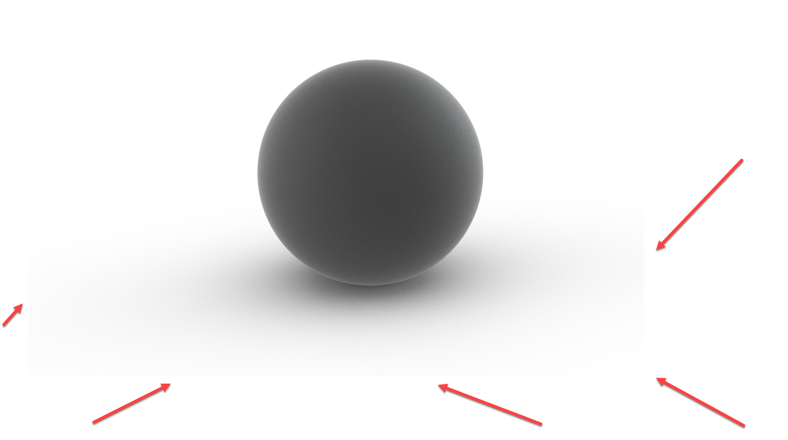

Paul, here's a couple of examples why we were using shadow catcher with opacity map.
When using Shadow Catcher , it's hard to see where your shadows fall and how far it goes. And final renders in our case always composited in some presentation with lots of renders. When you try to re-scale & arrange the renders you may end up with visible edges (cause shadows fall on them). See example on the screenshot below, after re-scaling the render you can see "edges" because shadows.
To eliminate this issue, we were using mask in opacity channel. And to see this in Rhino viewport we have a copy of our plane (but with Rhino material & texture). This way we have a visual representation in the viewport where our shadow catcher will be faded to white by Opacity map.
So, it would be great if you can help us get this feature back - Opacity channel for Shadow Catcher.
