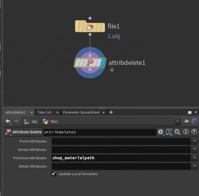

Probably the problem is that the imported .obj files already have a shop_material path primitive attribute pointing to a wrong material. You need to delete this attribute or modify it to point to the right Octane material.

Have you tried to delete the shop_materialpath primitive attribute?
